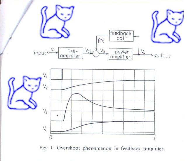

His key article "Circuit design modifications for minimizing transient intermodulation distortion in audio amplifiers" starts with this statement
Transient intermodulation distortion appears in power amplifiers when a feedback loop is extended over several stages and the open-loop cutoff frequency of these stages is lower than that of the preceding preamplifier stages.
and he uses the image attached. This statement is completely wrong, because TIM does not depend on OLG corner frequency at all, it depends only and only on slew rate of the circuit after closing of the feedback.

PMA, which came first, the need for feedback stability or TIM?
You may have 2 circuit solutions, both with 100Hz OLG corner. One would have 0.5V/us and the second would have 100V/us. Both really do exist. So, it is pointless and wrong to state that it is OLG corner that defines TIM. It is neither OLG corner, nor feedback factor. It is only slew rate that defines TIM, and slew rate depends on circuit design and components used. Yes, stability is a must, but again stability depends on circuit design and compensation scheme.
It appeared, at first, simply by observation, that higher open loop bandwidth meant higher slew rate, but it was NOT always so. This is a 'flaw' in Otala's original argument, but it did NOT ultimately settle the argument, because we found that higher open loop bandwidth was ALSO necessary to make circuits sound good, for the most part. Therefore, the question was still open as to WHY? This is where PIM came to become at least as important as TIM, first with Matti, but also with many others, including me, over the decades. We only want the ANSWER to the problem, not harping on the oversights of the pioneers who started the task.
