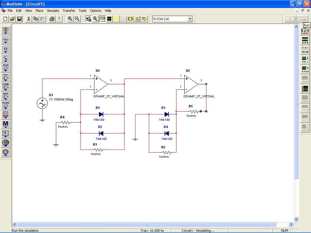

Math can do a decent model if everything is right. I have done a bit of that. Now reality gets a chance to rear its' head. I will build two non-linear amplifiers and measure them alone and in series both ways with and without global feedback.
Almost no one ever argues with actual measurements. Some one did once but it turns out they misread just about everything in the article. (See LA Vol. 1 Letters!)
Ed how about using non-linear blocks in LTspice? You can make your amplifier chain anyway you want; just put your formula in the nl-block and look at the transient simulation output.
jan
There are lots of ways to do the math and simulations, but actual hardware is very easy to do and leaves little room for argument.
It is even easier to speculate about the math with even less usefulness!

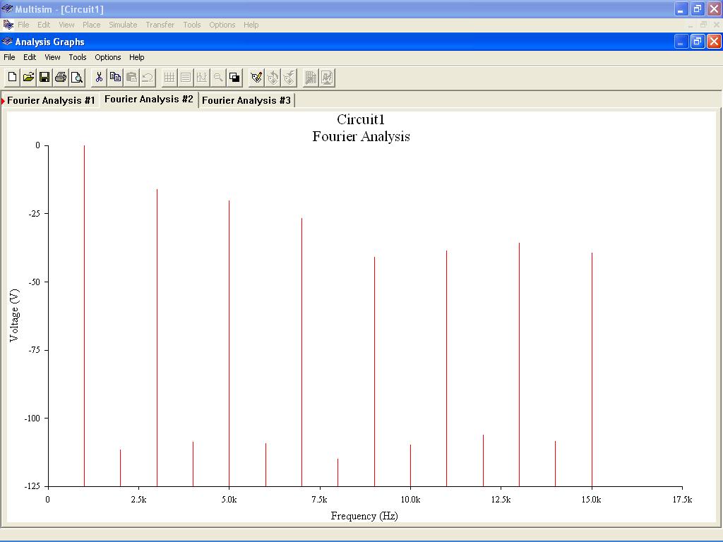

Jan,
FYI
Schematic of high distortion cascaded amplifiers and the results. First is the schematic, second is output from the second amp as shown and third is with the amps positions swapped.
ES
