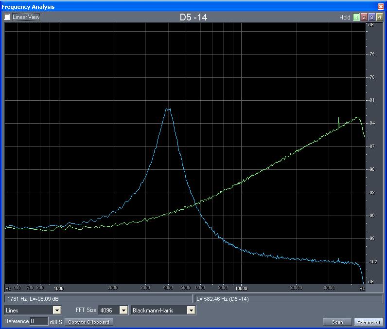

OK, I built the JFET buffers (2SK369's) so the head is unloaded. Much nicer results. This was easier than I thought, after resonating the inductance with two caps I found the L is basicly unchanged so we can ignore that half. It was .048H BTW. I then followed the proceedure in the Melcore app note (BTW they make one of the better xDSL transformers) and found the relationship, Rs = 385 + 1982(f/10k)^1.25 fits the data nicely. This is much worse than the typical audio coupling transformer (.35-.45 power of f).
The picture shows the unloaded noise and the noise head resonated with 33nF of capacitance.
My line of reasoning, at low f the noise is asymtotic to 385 Ohms on both plots and at the high end on the L/C resonance plot it is asymtotic to the preamp rti noise. From this I computed the preamp to be 1.87nV, reasonable. From this I computed the resistance from the noise at 10kHz and subtracted the 385 Ohm series resistance. I then fit the data and equation with a couple of iterations of lying them on top of each other.
So there you go JC you were right, eddy losses are a much bigger problem on tape heads than coupling transformers.

Out of time, quick correction the plot is with the 8.2nF cap so the head inductance was .193H, the exact value of L falls out anyway unless we do the parallel/series transformation.
My SPICE lets me enter an equation for R vs f in a noise analysis but the answer is garbage, so I will need to step one f at a time to verify the shape of the resonant plots.

1. When you unloaded the head, what was the difference in the noise profile?
2. Can we state that loading the head created more eddy current losses as a result of the loading current? Is it worse. Or, is that not discernable given the data.
Now, given the setup, do you think it will be useful for doing the 4 core test? Where we can really determine the overall effect by changing the eddy current possibility?
edit: After thinking more about it, I still believe driving a sine and looking for sidebands is more consistent with examination of eddy effects. I can do some testing on the HP LCR if it'll help..
The noise profile was screwed up a lot, I didn't know the mic pre was only 6k (it usually sees 200 Ohms). This makes the problem like telling the difference between 6K and 6.5K only measuring noise. The 4 core test should work fine and I'll get right on the sine test as soon as I get my generator repaired. I will check a mike input transformer, though I don't have a phono one around. I also should verify the results with my GR impedance bridge at at least a couple of frequencies too.
