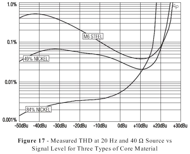

The following is a quote from the link I posted here (thanks Pano:) : http://www.diyaudio.com/forums/analog-line-level/146693-john-curls-blowtorch-preamplifier-part-ii-1114.html#post2501525
But in a real transformer design there is a fixed relationship between signal level, distortion, and source impedance. Since distortion is also a function of magnetic flux density, which increases as frequency decreases, a maximum operating level specification must also specify a frequency. The specified maximum operating level, maximum distortion at a specified low frequency, and maximum allowable source impedance will usually dictate the type of core material which must be used and its physical size. And, of course, cost plays a role, too.
The most commonly used audio transformer core materials are M6 steel (a steel alloy containing 6% silicon) and 49% nickel or 84% nickel (alloys containing 49% or 84% nickel plus iron and molybdenum). Nickel alloys are substantially more expensive than steel. Figure 17 shows how the choice of core material affects low-frequency distortion as signal level changes. The increased distortion at low levels is due to magnetic hysteresis and at high levels is due to magnetic saturation. Figure 18 shows how distortion decreases rapidly with increasing frequency. Because of differences in their hysteresis distortion, the fall-off is most rapid for the 84% nickel and least rapid for the steel. Figure 19 shows how distortion is strongly affected by the impedance of the driving source (the plots begin at 40 Ù because that is the resistance of the primary winding).

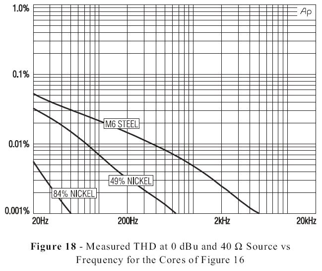

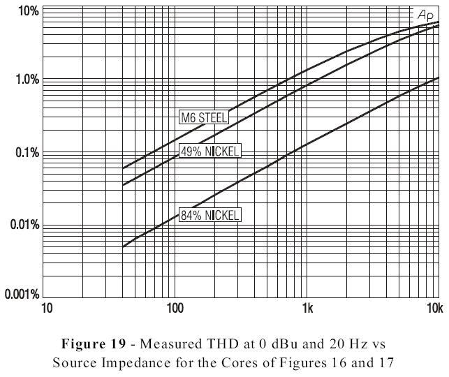

... according to Mr. Jensen, your worry about IMD may be misplaced.
"...note that distortion for 84% nickel cores roughly quarters for every doubling of frequency, dropping to less than 0.001% above about 50 Hz. Unlike that in
amplifiers, the distortion mechanism in a transformer is frequency selective. This makes its IM distortion much less than might be expected. For example, the Jensen JT-10KB-D line input transformer has a THD of about 0.03% for a +26 dBu input at 60 Hz. But, at an equivalent level, its SMPTE IM distortion is only about 0.01% — about a tenth of what it would be for an amplifier having the same THD".
...from http://www.jensen-transformers.com/an/Audio%20Transformers%20Chapter.pdf
