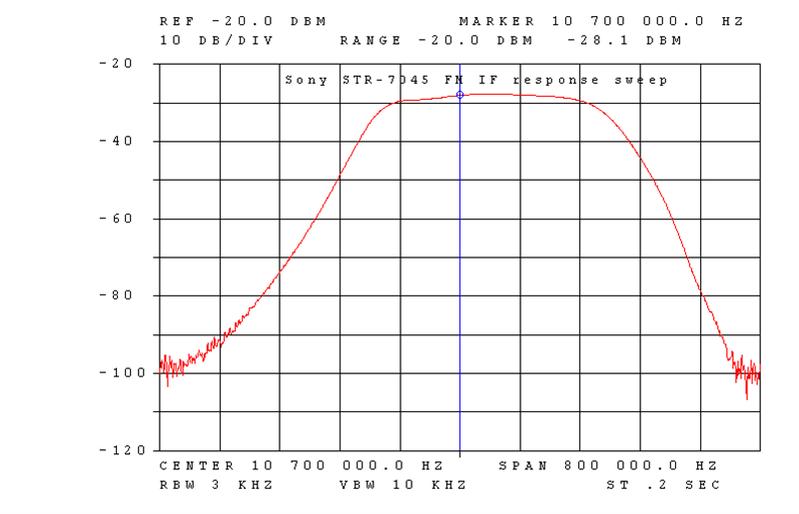

Hi Anatoliy,
With FM modulation, you get a continuous spectrum. With square wave modulation that is working perfectly, you will get what is called FSK, or frequency shift modulation. The only time you will have a discontinuous spectrum with FM that I know of is if you are sampling in some way. However, the center frequency (or carrier) is changing continuously between the peak high extreme and the peak low extreme of the deviation, or change in frequency. That continuous sweep back and forth "looks" like a continuous spectrum. I'm looking at an FM IF sweep right now, here it is.
Notice that it is continuous in nature. The input is a swept 10.7 MHz center, 800 KHz range. In other words, the high frequency is 10.7 MHz and the low frequency (modulation) is 5 Hz (inverse of sweep time). My earlier post showed 10.7 MHz modulated by 1 KHz, so take your pick from these. I can, and later will, try with the lower frequencies that this thread is concerned with. I don't have time right now and the generator I'm using (HP 8656B) only goes down to 100 KHz. I'll need to use an HP 3324A and 3336B in order to recreate the exact test setup used by John. That is why I have been asking for his test setup - so I can see what he is seeing.
Modulation in a linear analog power amplifier will be AM for the most part, FM modulation is what I think they are looking for, and may occur at very low modulation depths. Can you imagine listening to an amplifier that is being modulated using FM? That might be somewhat like listening to a turntable suffering from wow and or flutter. A frequency effect hard to miss.
Best, Chris
Best, Chris
