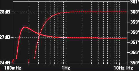

I use a 10µF as the first stage of one of my 18dB/oct servos. But, as it is followed by a 12dB/oct filter, that reject any frequencies higher than some 0.5 Hz, I do not really care about distortions it can produce ;-)
(BTW: no visible phase shift at 10Hz.)

Servo's are usually tuned to become effective below 1 Hz or something, and typically have 2nd order filtering properties AFAIK. The bleed through of a servo at low frequencies (~60dB @ 30 Hz, 72dB @ 60 Hz) therefore is higher than the aberrations that would be introduced by a coupling cap . Do the math, or in case of emergency, measure. Now, this bleed through does not per se introduce distortions, but it will cause phase shift.
Fully agree, but also look what happens at high frequencies. In an ideal servo, there is NO high frequency bleedtrough to speak of. For instance, if your cut-off is 1Hz, and the servo has (normally) a 6dB/oct slope, by the time you reach 256Hz, you're 8 octaves up so for that 256Hz the bleedtrough is -48dB. At 16kHz, its -78dB.
Now, this assumes that the servo opamp has enough loop gain, and is linearly enough, so that the -72dB bleedthrough at 16kHz causes just a minute change in frequency response. BUT if that opamp does not have enough linear loop gain, the bleedthrough can be a distorted version of the original signal and be much larger than -72dB. So this servo can easily cause more hf distortion than the whole rest of the amp!
Counter-intuitively, even if the servo has its main task at VLF, use a good opamp with high loop gain and low distortion at the hf part of the audio spectrum.
The upshot is also that a servo can easily distort orders of magnitude more than a good coupling cap. Also that a super-duper servo cap can be completely undone by an unfortunate choice for the servo opamp.
