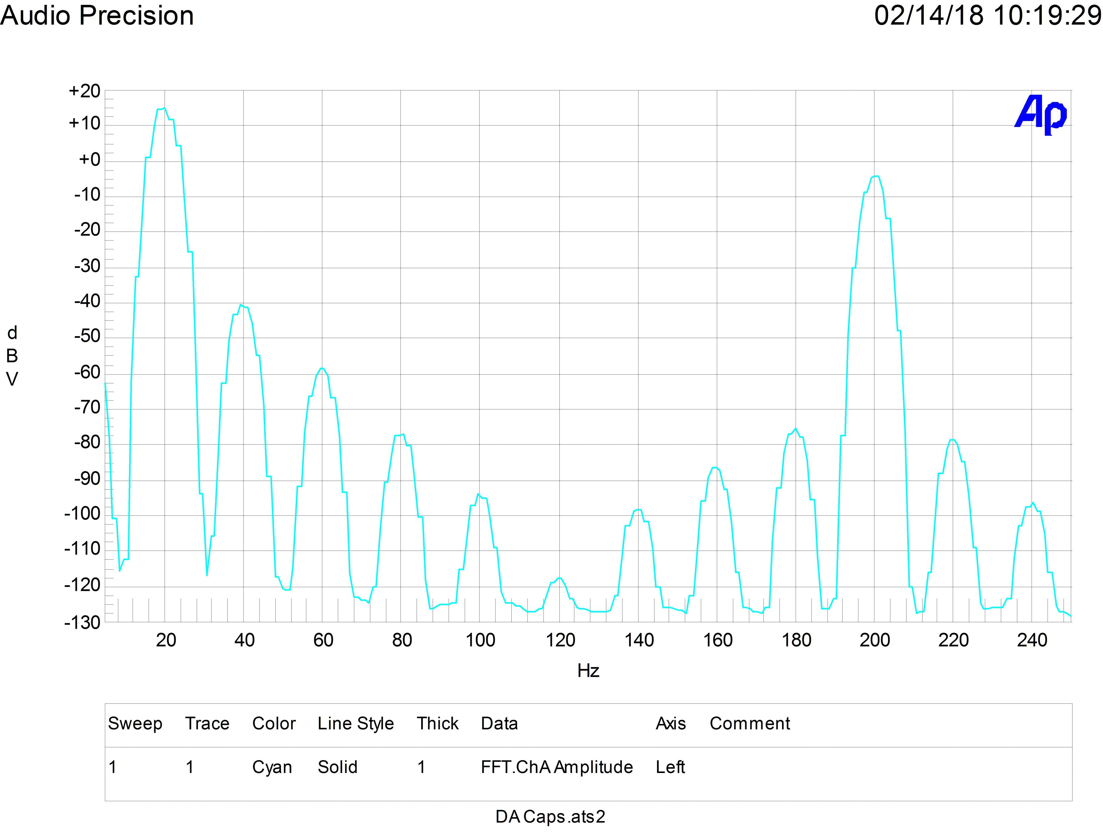

Ed - I forgot >big smileys< here just trying to help. The trail of almost equal height harmonics is a big red flag and means time to subtract out the fundamentals and look at the residual in the time domain. The usual suspect is a discontinuity or glitch in the waveform smooth low order behavior can't do this. It's the old intellectual curiosity thing again, I can't help it.

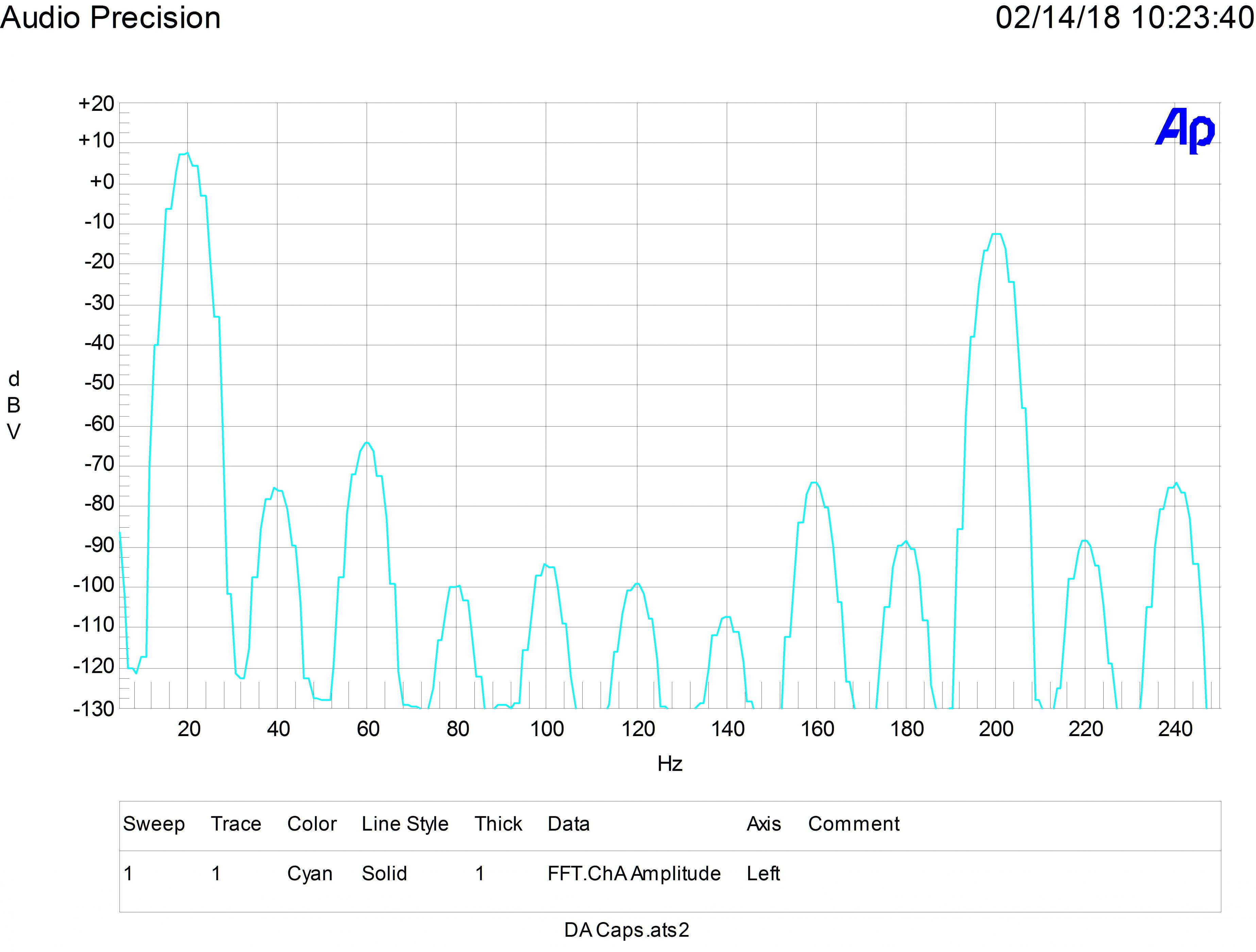

I doubt there is any intermodulation. What I see are the 2 carriers , harmonics of the
20 Hz and maybe a little hum. Remember that the amplitude of IMD drops quickly
with the order, because high order IMD is made by mixing the low order IMD
again and again. Since IMD3 products are already weaker than the original carriers,
IMD5 products must be _much_ weaker than IMD3. I do not see anything like this.
When doing IMD / intercept point measurements I also found it absolutely necessary
to decouple the generators with attenuators _and_ bridges/directional couplers or the
output stages of the generators would happily intermodulate with themselves.
A common amplifier for the 2 signals is completely impossible, even when measuring
simple amplifiers. Normal signal generators @ 13 dBm_out do not have the level
to be combined after the attenuators and still deliver enough power for meaningful tests.
And such simple amplifiers are expected to be grossly nonlinear, not slightly like
passives that are linear in first order.

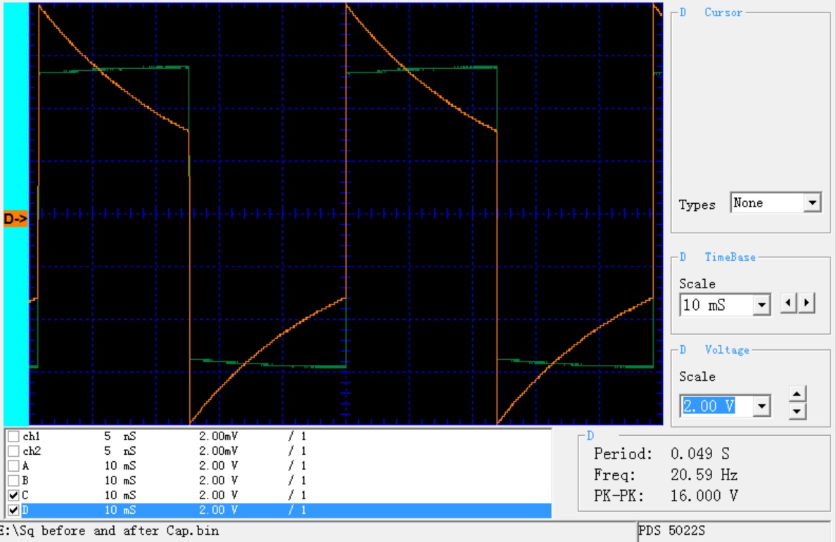

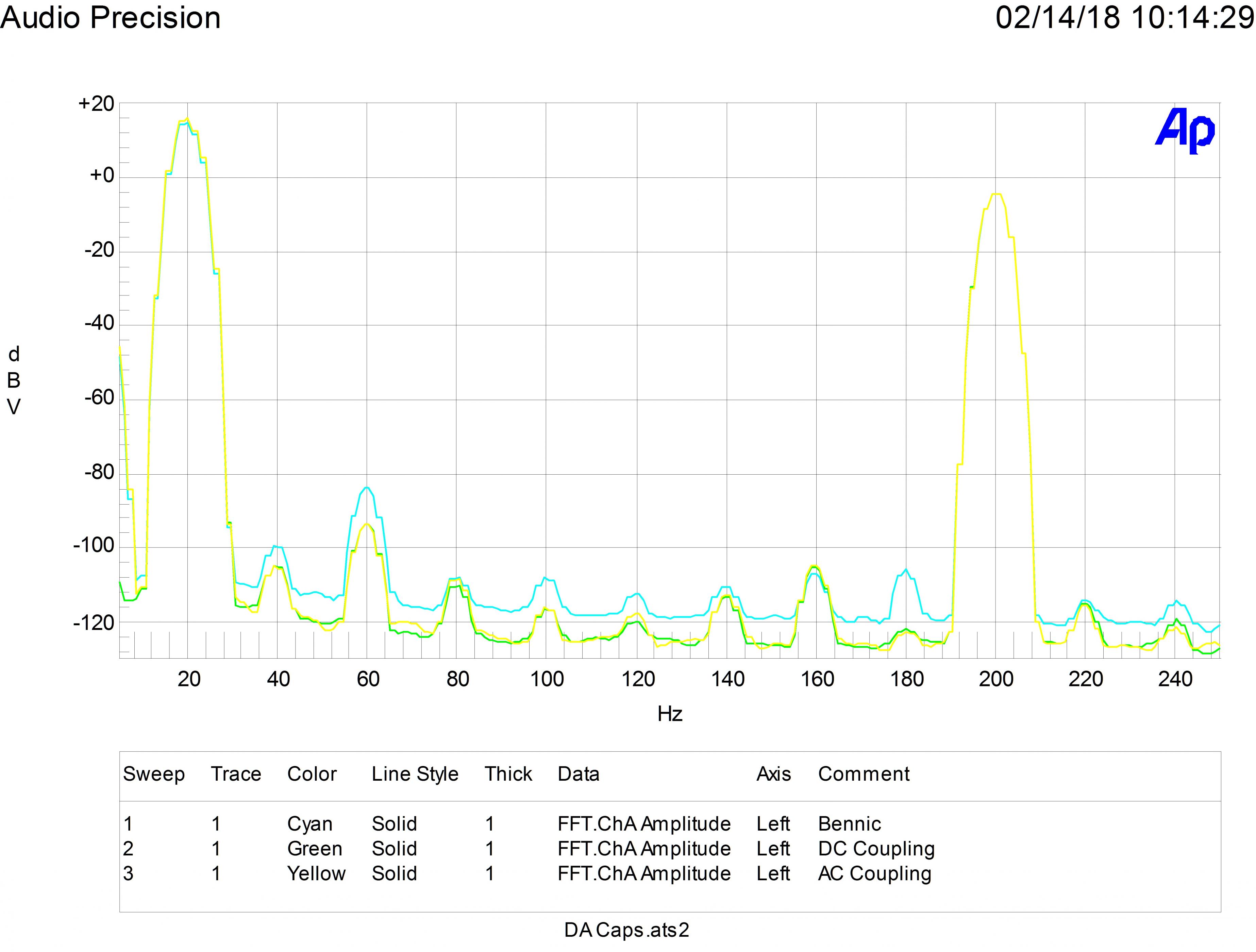

First image is the 1.8 uF Bennic capacitor into 10,000 ohms compared to the AP's output DC coupled and also using the internal AC coupling.
Second image is a not very good 2 uF capacitor with the same test waveforms. As capacitors with high Dielectric Absorption also have other faults it is difficult to isolate what factors cause the THD and IM distortions. At least one DA model has voltage dependent resistors.

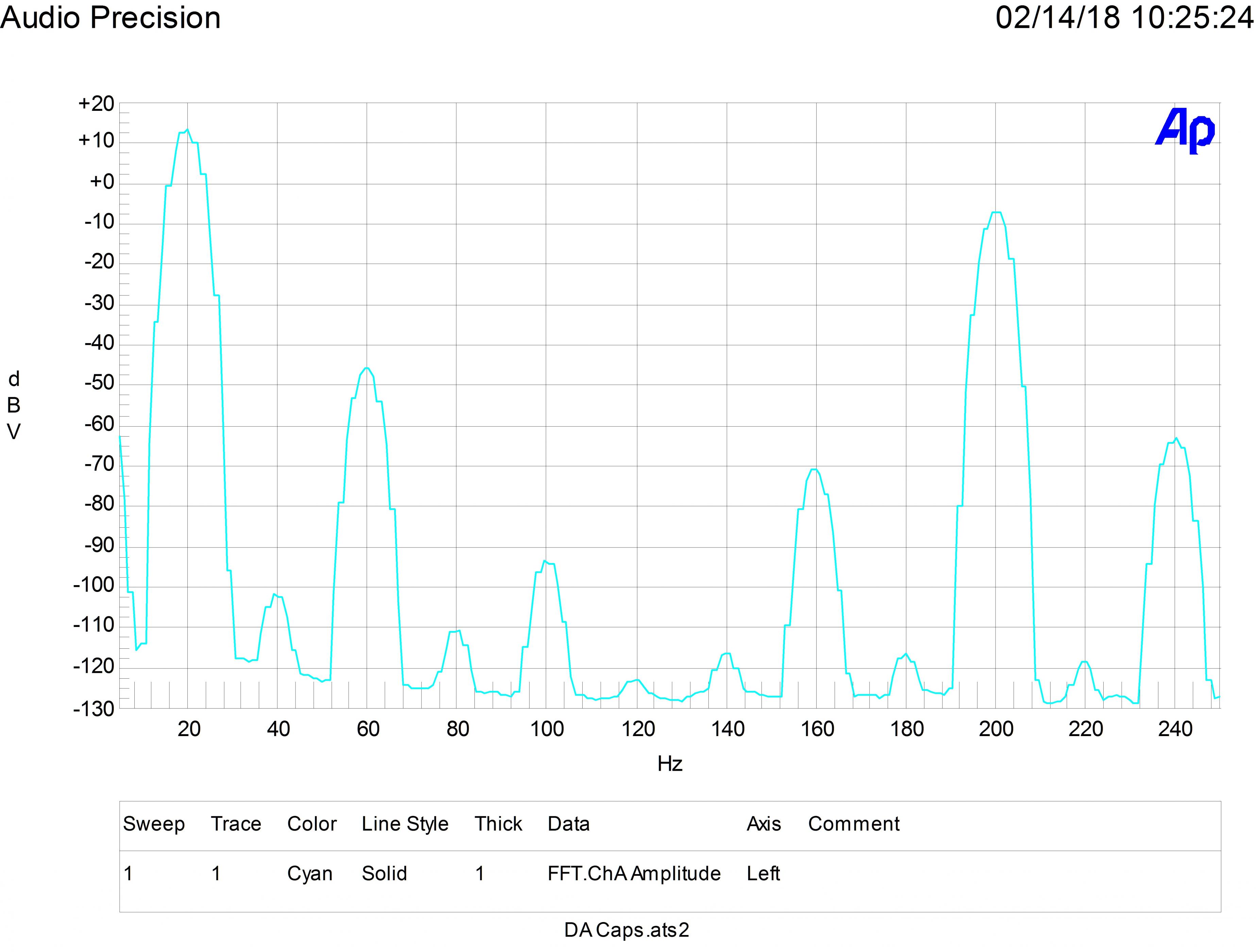

The last two images show results with no capacitor just nonlinear resistors.
Two ideas here. First is that DA does decrease sound quality. Second is the frequency where the impedance of a capacitor equals the load resistance will create the most IM distortion due to the exponential charging current deviation from a straight line.
I have observed consumer integrated amps with LF cut switching causing a boomy/lumpy/resonant quality to the bass......Two ideas here. First is that DA does decrease sound quality. Second is the frequency where the impedance of a capacitor equals the load resistance will create the most IM distortion due to the exponential charging current deviation from a straight line.
Without voltage/current variable capacitance and/or resistance (assuming no L's) there is no mechanism for distortion other than pathological issues. Victor, Samuel and others have identified several commercial caps that have no meaningful issues so why bother?
