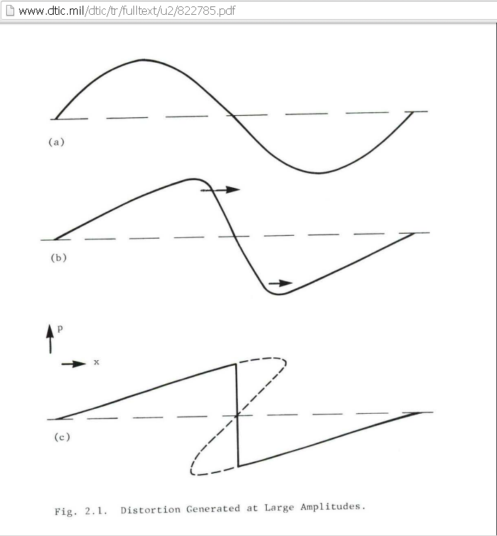

>and more interestingly the air became extremely non-linear
>since it can theoretically be compressed to infinity at room temperature,
>but only rarefacted to a vacuum, or 1 bar.
We have visited this subject again (Thuras et. al).
Not really applicable for sound levels in audio world. Ed may be on the border line
http://www.dtic.mil/dtic/tr/fulltext/u2/822785.pdf
https://calhoun.nps.edu/bitstream/handle/10945/16760/propagationofpla00pest.pdf
