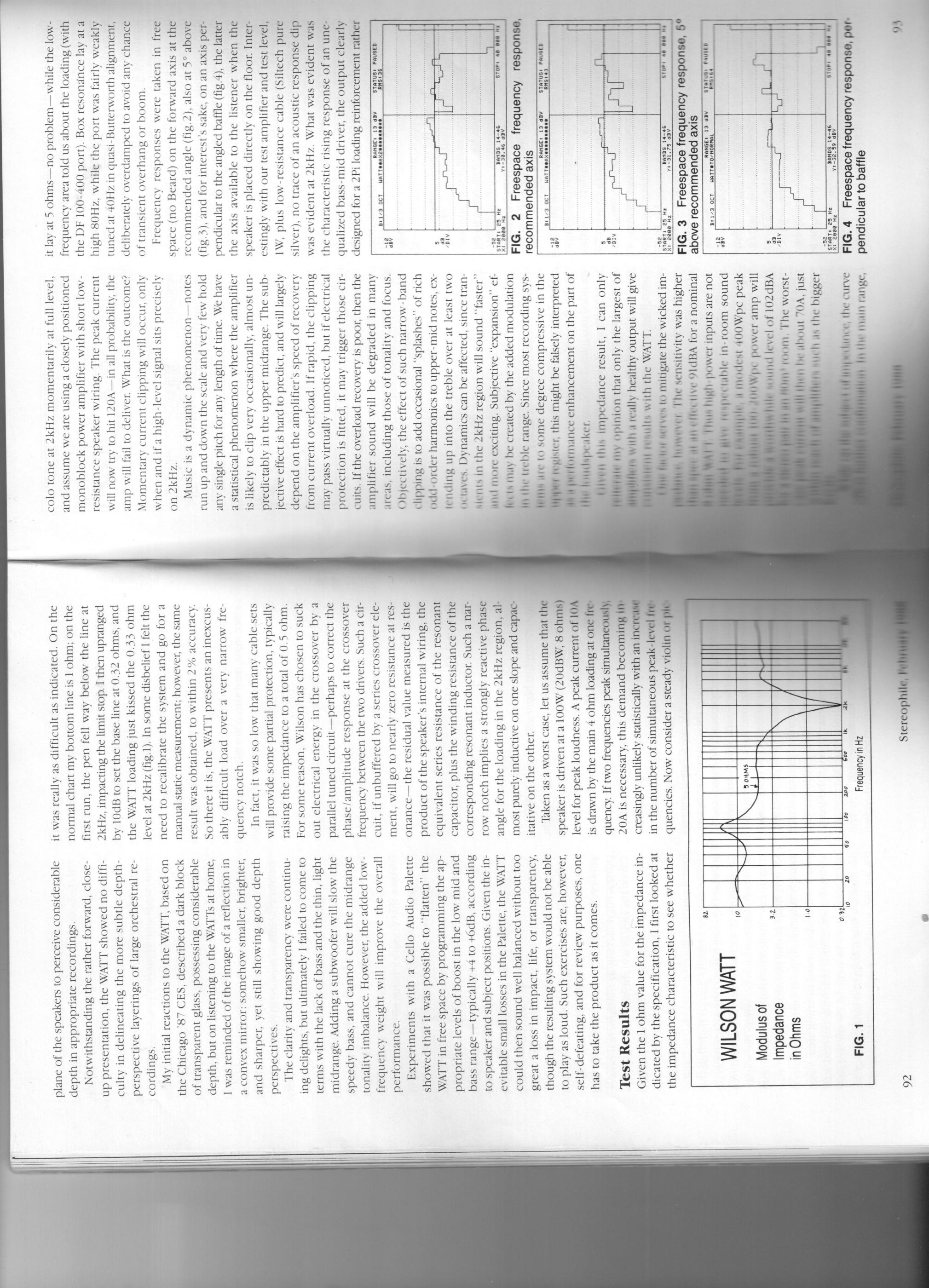

Here is the curve as measured by 'Stereophile' on the WATT1 speaker impedance. Pretty scary! It is probably caused by a single L-C combination to ground in order to correct for tweeter fundamental resonance. Of course, it was an oversight, but hard to fix without changing the entire Xover, from what I gather.
For the record, Matti Otala's work on speaker impedance is paramount to get a more 'worst case' understanding of speaker loads.
