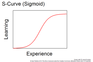

This curve is what I run into in audio ---- Without real world experience, in making successful high-end audio designs, sufficient knowledge is not attained.
