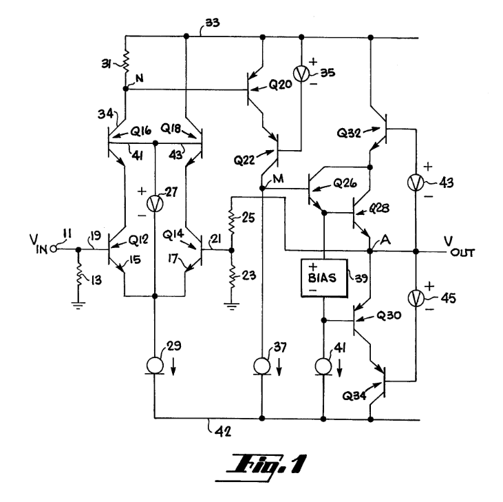

It seems to me you could make a pretty low distortion output stage if it were
The schematic below shows the general idea. Simply replace Q28 and Q30 by Sziklai pairs and you've got it. (Circles with a "V" inside (e.g. item 43) are ideal voltage sources, to generate the cascode biases).
Feel free to substitute MOSFETs for selected BJTs, if you wish.
_
- Constant Current
- Constant Voltage
- Class A
One way to accomplish this, might be to use a Sziklai output pair. This gives constant current operation of the follower. Then cascode the Sziklai, and bootstrap the cascode, to give constant voltage operation. Voila, constant current AND constant voltage.
- Constant Current
- Constant Voltage
- Class A
_
There was a DIY design for an amp that did something a lot like that, back in the late 80's - early 90's. The active output followers were power FETs, with power bipolars bootstrapping them for constant Vds. The mounting flange on the heatsinks got quite crowded, but as racing engine designers say, "There's no substitute for cubic inches". Low distortion, and since the output current was divided among so many output devices, it was bulletproof. I built one for a friend of mine running massive, hideously capacitive electrostats, and tested if by driving a full-power squarewave into a HUGE 4 uF cap, preceded by an equally huge custom non-inductive 0.25 Ohm power resistor that we christened "Frankenstein's Zobel Network". Basically, a homebrew Bryston for design masochists who 'just gotta do it themselves'.
