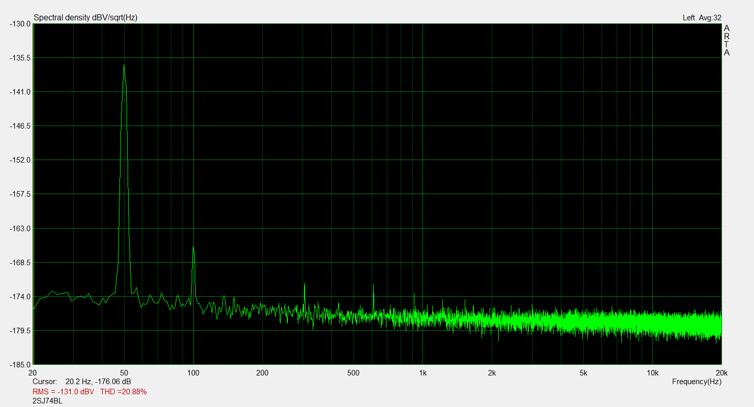

We tried different driver mosfets, different output bias, etc, with little success. I had to add another 2 pairs of output parts per channel to get better performance. Looking deeper, we found that they had used the wrong P channel input jfet,(this gave higher 2'nd harmonic than usual) the smallest surface mount parts on the driver board, etc. We had them fix all that. The final result is better, but not perfect.
Can you share, if you remember this detail, the name for wrong P-channel and for its fix?

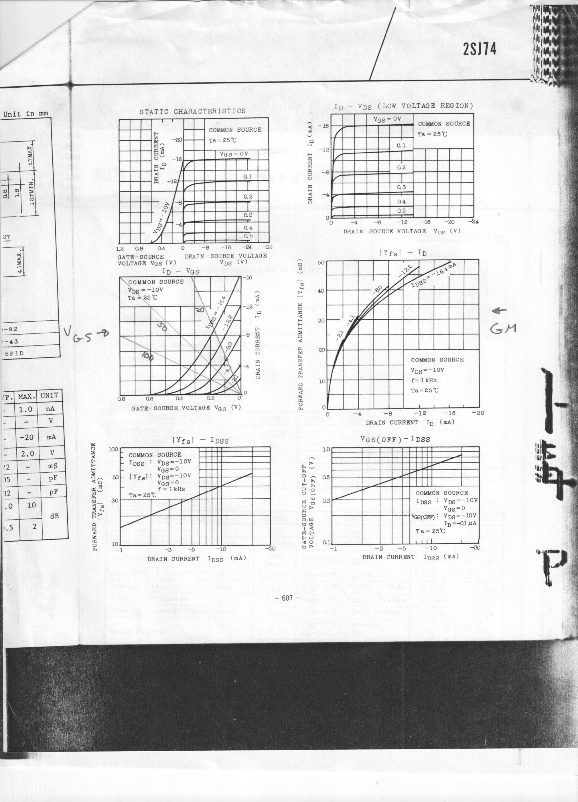

Here is some jfet history:
Complementary jfets first became generally available from Motorola back in about 1970. These parts were the low Gm type, with a Gm of perhaps 3-5K umho. They have remained useful, but not as useful as what came later from Siliconix. Siliconix in the early 70's started to make complementary jfets with higher Gm, so we started using them in newer designs, including the complementary differential jfet input stage that we first started to use commercially in 1973. Since then, and now about 45 years later, we still make preamps and power amps with this same input stage. By 1980, there was a revolution in complementary jfets that were released by a number of Japanese manufacturers initially, and later many dropped out of production, but Toshiba remained essentially a single source supplier of various configurations of the 2SK170 and the 2SJ74. The apparent superiority of this parts pair in some form, became a mainstay of Parasound's preamp and power amp designs for the last 25 years. Unfortunately, much like many other Japanese manufacturers, they pulled the plug, so to speak, and we were left with a deficit of these jfets, especially the 2SJ74, and the prices started to rise, perhaps 20 or more times, due to the scarcity of these parts, with no cost effective substitute. Parasound, itself, started to run out of these parts, so in some amps (the cheaper ones at first) they substituted the 2SJ103 that looks and acts similar, but has much lower Gm than the part it replaced. This effectively creates a gain difference in the differential stages, and this actually changes the second (driver) stage more by creating an unbalanced drive to the complementary pairs that are driving each other. This caused a lot of extra 2'nd (even order) harmonics that would normally be balanced out with the proper part.
The amp that I was testing was not a cheap amp, but a more expensive, mid-priced amp, this replacement was inappropriate for its position in the amp lineup.
Now here are some spec sheets of the two fets that were used, note the Gm of each.
