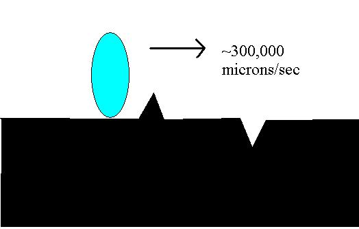

A little back on topic, the "impulse" response of a phono cartridge. First off I don't see it being symmetric at all. Secondly on a positive impulse-like vinyl feature the stylus will leave the surface and exercise the mechanical properties of the vinyl on its return (this can be seen on actual data). Once the thermal properties of the matierial are involved the problem is much more difficult.
In researching stylus geometries I finally found an answer to something that has bothered me for years. The actual contact length for a .2mil elliptical and line contact stylus are the same (~3.5 microns). The height and therefore the contact area are very different. This is why the third octave noise intermods are not much different.
One more thing even more on topic. It is pretty easy to argue that the tip mass resonance is decoupled enough from the motor assembly that damping it with cartridge loading is not very effective. I might be wrong but I would love to see some real evidence.

We have known for years that tip resonance is NOT effectively reduced by external electrical damping. However, listening shows that loading does effect the audio characteristics of the better MC phono cartridges. This is why we provide variable loading in upscale phono playback systems.
The problem is, that only spheric tips have pretty much a constant contact area, as long as it is mounted on a usual cantilever.
Because the cantilever have to move, it changes the angle of the contact area. Since it is elliptic and not round , the area will vary depending of modulation. Of course, spheric tips have the same angle /phase error ,but the contact area does not change this way.
This creates specific distorsions for every kind of stylus and is part of the specific *sound* of every cartridge.
With spheric tips of radius apx 17 mikrometers the distorsions are known and can be calculated by math and thus a compensation can be made ( was also done sooner).
Tip mass, motor mass, cantilever mass and so on create a resonance. If well done, it will be around 19 Khz. Almost with MCs. And now you can load resistive for damping. ( you can also calculate the math)
At MMs the cable capacity and 47 Kohm loading will shift the resonance in this area also.
Since cutting heads in the 60s /70s had a resonance in this area, a notch filter was used, to avoid destroing them.
Now the cartridge resonance could compensate this loss pretty good.
My only point was that line contact stilii are not chiseled down as sharp as a cutting stylus or they would destroy the LP. "The math" involves a lot of mechanical constants not usually published, and as JC said the sonic loading effects are not due to this damping but the usual anecdotal listening tests by the GEB.
