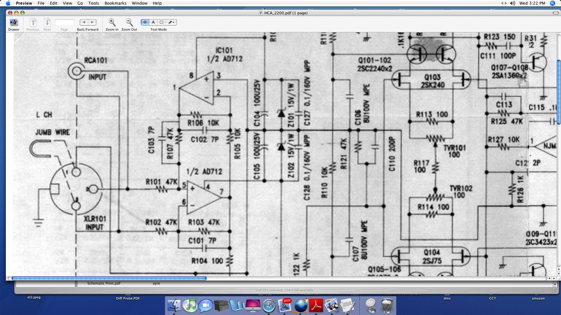

Now for something else. Here is the deleted input stage (IC101) that was originally in the HCA2200 about 25 years ago. Why don't we build it up and see if we can hear it, or even find a measured problem with it?
What the heck, maybe I was wrong, and we could use this stage anywhere!

Where did you get those 7pF caps. You needed a 2MHz time constant in an offset servo maybe it was just oscillating?!?

Good point Scott, do you think they are the wrong value? I did NOT design this input stage, the Taiwanese did. I just went along with them. Would another cap be perhaps better? Maybe we should measure it.
If someone else did the design the first thing is to ask why there is such a small cap in that position. Maybe it's just a placeholder and they didn't need to find an optimum value. I just think that in a very low frequency servo adding a 2MHz time constant seems strange. I've had audio circuits sound fine even though they were oscillating at 60MHz, sometimes the opposite is true.
