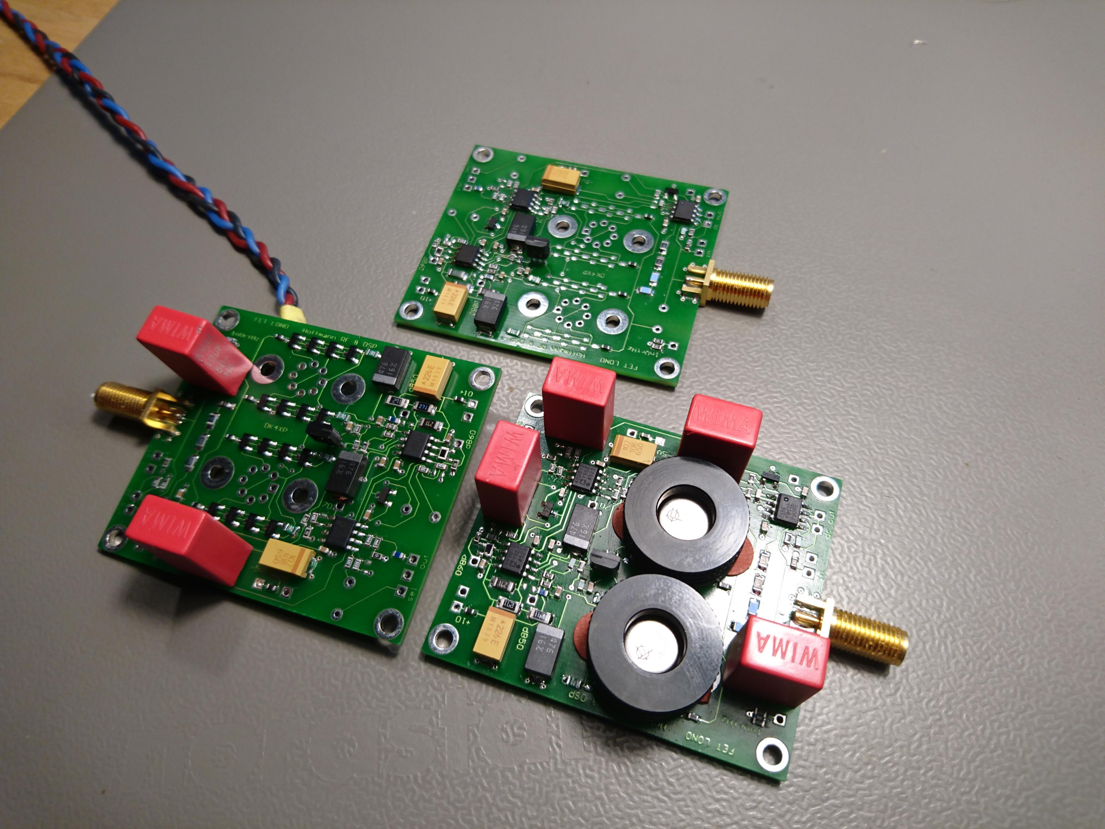

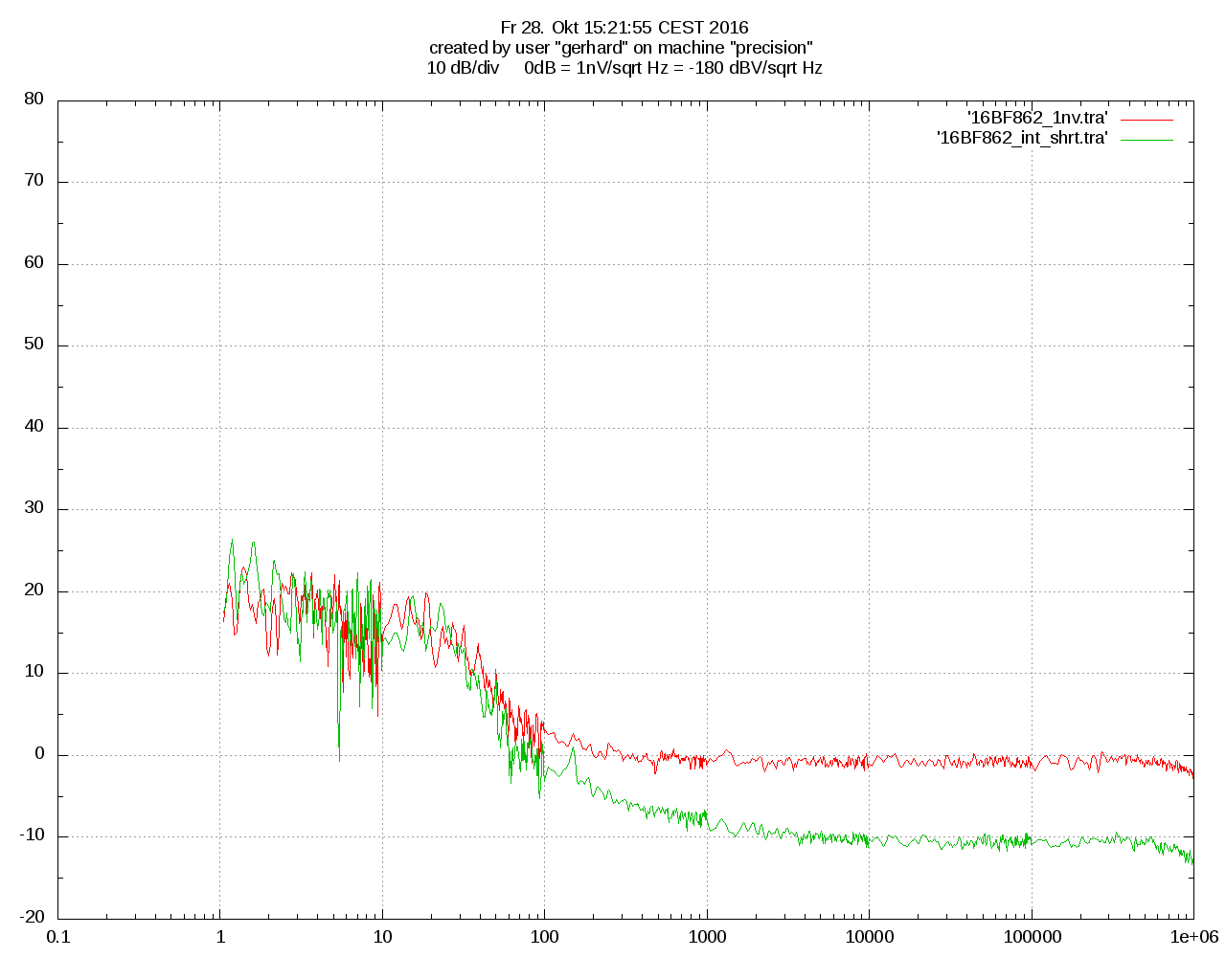

While I'm at it, that's the noise I get from 16 BF862 at 44 mA tot., cascoded
with ZTX851, Post amps = ada4898, Bias servo with opa2143.
Servo still needs some work.
Red trace is 60 Ohm thermal noise = 1nV rtHz, green is input shorted.
10 dB below 1nV, or about 320pV rtHz.
The same board can be populated with 2*IF3602, not yet tested.
While I'm at it, that's the noise I get from 16 BF862 at 44 mA tot, cascoded
I see the FFT "stitching" is that bump at ~20Hz real or an artifact? I await the IF3602 measurements, I have 5 in the bin.
It is one FFT per decade, corrected for bandwidth, from an Agilent 89441A signal
analyzer. The decades have been stitched together by gnuplot that is fed from a
C program under Linux that controls the 89441A via LAN.
Input coupling is 10u foil * 4*47Meg, probably temporarily less because the
settling time stresses my patience.
Disregard the stuff below 20 Hz, the 1/f corner is a KHz or so.
Also the total gain seems to be one dB low. (only 79, not 80 dB)

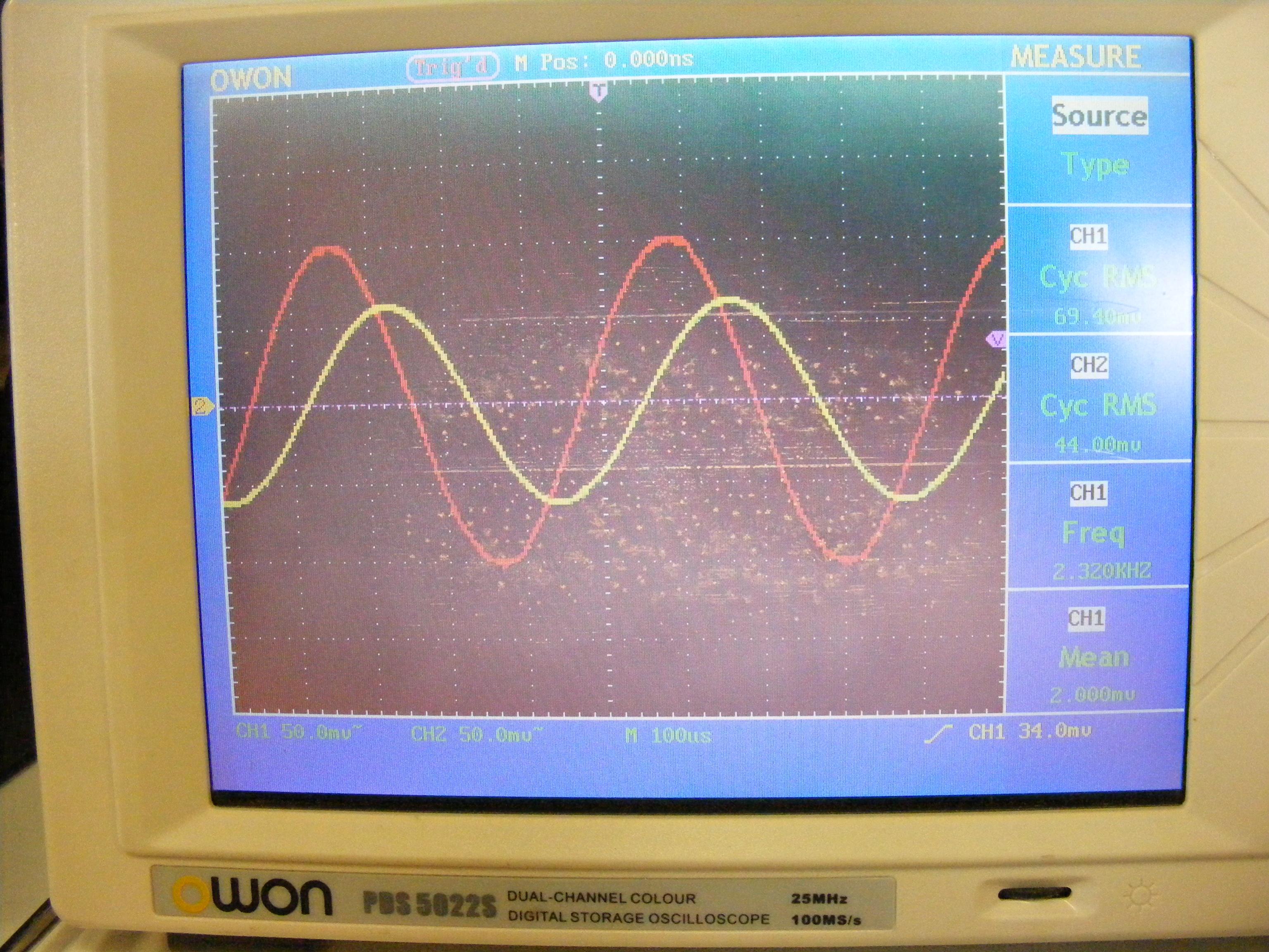

Gerhard,
Very impressive.
However as you and I are using similar tools to look at quite different issues, I will drop the quick results of my latest playing around.
I took a 50' piece of 16 gauge loudspeaker wire. Terminated one end with a 10 ohm resistor. Fed the input through a 1 ohm resistor to monitor the current through the cable. Also put a shunt across 1 wire with a 1 ohm resistor. At low frequencies the voltage drop thus the current through both resistors (short path vs through the cable) was the same. As the frequency increased the current through the shorter path decreased. Around 2K the short path was 3 dB. down!

The short path has the inductance of the loop of the black wire, an air core inductor of about 14 turns and 8 inches or so in diameter.
The current through the cable pair has inductance of about .2 nH per foot.
John
That's a no-brainer. Therefore, I am eminently qualified to answer.
John
We just gotta disagree. I think it is the inductance of the red wire. But do note the cable is "counter coiled." (First loop one direction, second reversed.) Putting a bit of steel in the middle of the loop seems to have no effect.
(Sidebar for extra points! How much inductance is required to cause the drop shown?)
Then there is the capacitance causing more phase shift with increasing frequency.
Next up is to run HF bursts through the cable, but first I have to rig up the right test equipment.
I only asked because your 1-10Hz looked perfect and would extrapolate nicely down to the 100-1k plot, just the 10-100 looks anomalous. I once did one of these plots down to 10uHz to prove GR noise just hides 1/f. One of the disagreements I had with the LIGO guys was that one should be able to make FET's with .001Hz corner frequencies, I'm not sure any current structure would support that.

Your coil of cable does not match your description of "counter coiled".
Second, no schematic.
Third, you look to be confounding the short current measurement with the CVR.
Fourth, what is a "bit" of steel, and how sensitive do you think the breakpoint would be to a fractional increase in inductance and a fractional increase in series resistance? Remember, your coupling to a "bit" of steel isn't going to be very good, as the gap between the steel and loops is the very definition of "parasitic inductance", and it is that parasitic inductance that you are seeing.
Your setup is entirely uncontrolled and undocumented. Again, this is a common theme of yours I bash you for.
That's why I wrote the servo needs some more work. I had problems with
motorboating and a lower passband corner at 0.1 Hz. With a settling time in
minutes one really cannot see what's going on, so for now I increased some
corner frequencies and want to scale them back when I have a combination that
both works and is not damped-down like Prince Valium from Star Balls.
I regulate the collector voltage of the cascode transistor and it is stable to
the uV scale, clearly unnecessary loop gain. I want to play this weekend
with the LTspice loop gain probe. Also I found that I cannot measure a 100Meg
resistance, the world seems to end at 20Meg, and even the FET probe of the
scope introduces a Heisenbug. (Observing it affects the outcome.)
BTW with the dual IF3602, the can is isolated from the gates; it would be
hard to be fair to the 2 transistors otherwise.
