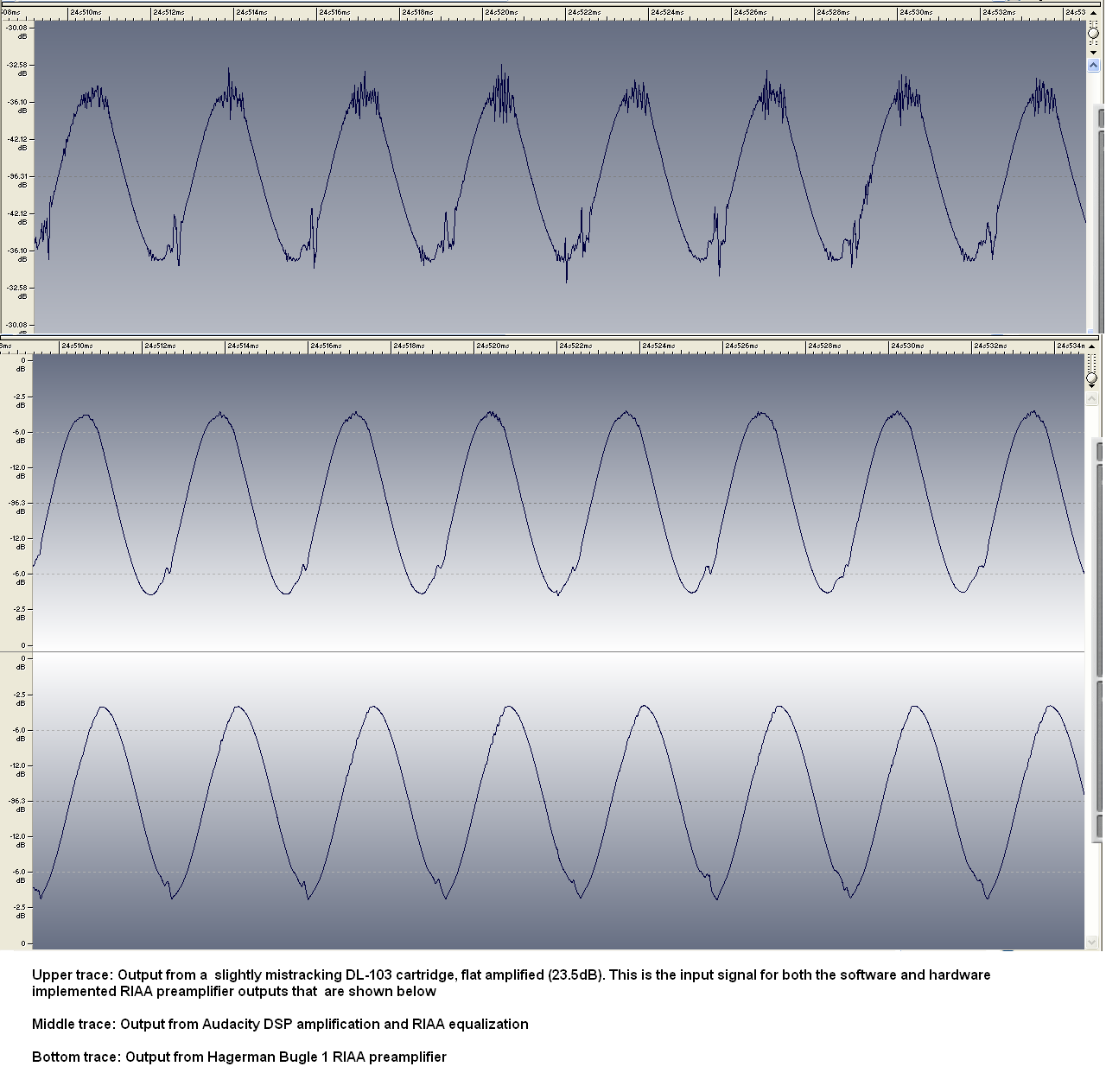

Scott, sorry for responding late.Agree, from your picture above it seems your pre-amp didn't behave badly. Just what else should it do?
The preamplifier performs very well but not perfectly well. See the attached waveforms.
Vinyl track: HFN Analog Test LP (002) Side 1 Band 9: L+R 300Hz at +18dB (39.7cm/s peak)
Turntable: Thorens TD-160 Mk-II (modded),
Tone arm: SME-3009 Imp (modded)
Cartridge: Denon DL-103 (modded)
Head preamplifier: flat, 23.5dB diy based on Nat Semi AN-222 Fig.4 .
RIAA preamplifier diy based on Hagerman Bugle 1
Sound card: M-Audio Audiophile USB
Cartridge output feeds the input of head preamp.
Head-pre L Output through a Y adaptor, feeds both Hagerman Bugle RIAA preamplifier L Input and M-Audiophile USB sound card L Input.
L Output of Hagerman Bugle RIAA preamplifier is fed to R Input of M-Audio Audiophile USB sound card .
Therefore, both channels of the digital recording represent the L channel of the cartridge (L channel of the recording is the flat signal DSP amplified and DSP RIAA equalized using Audacity 2.1, while the R channel of the recording is the flat signal amplified and RIAA equalized through the Hagerman Bugle preamplifier kit)
Initial recording: 22/96 wav. Stereo via Wavelab6.
DSP manipulation applied through Audacity 2.1 to the L channel of the original recording:
Amplification 25.5db and RIAA equalization (Bugle sim)
George

Audacity is linear phase (unless you do Nyquist prompt with IIR filter) real pre-amp is minimum phase. Neither of these look badly misbehaving.
Scott thank you.
You have mentioned this a few times but it seems that it will never be enough for me. I keep on forgetting it.

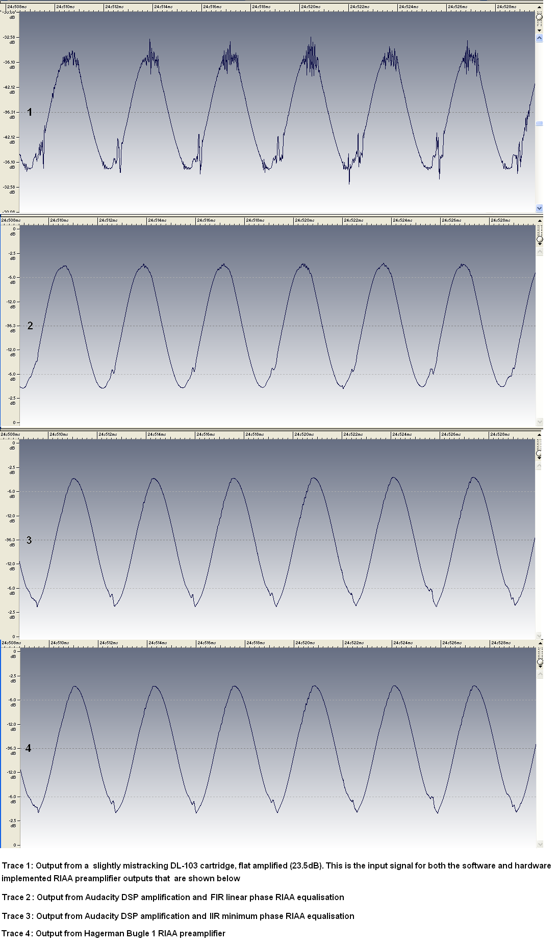

Not that an FIR can't be minimum phase.
Scott I quote from this site
Website of Wayne Stegall - Digital Phono Equalization
I tested this biquad in Audacity. It works OK as a IIR minimum phase RIAA filter but instead of a gain of one, it has a gain of –20dB.
Nevertheless I made up with an extra amplification.
George
· Open the Nyquist prompt
Menu → Effects → Nyquist prompt...
· Enter the nyquist biquad equation that the program generated. Note: If the dialog contains a check box labeled "Use legacy (version 3) syntax," check it. My current software only gives equations in LISP format not the newer SAL.
Example at 96kHz for a gain of one:
(biquad-m s 1.315951e-02 -1.273543e-02 0.000000e+00 1.000000e+00 -1.867054e+00 8.674785e-01)
George
Transforming a linear phase FIR to a minimum phase FIR is not that complicated, but the optimal design of a minimum phase FIR is a difficult mess http://users.ece.utexas.edu/~bevans/papers/1999/icassp/icassp99.pdf to the point that I would as much as possible avoid it.
George
I covered the same territory in my article, it turns out a simple two pass IIR gets ridiculously close to perfect even at 44.1kHz. Last two are looking pretty similar. Wayne does have some issues when you get past the audio stuff.
EDIT - Come on George it's nice if folks read your stuff but you could go to the horses mouth.
