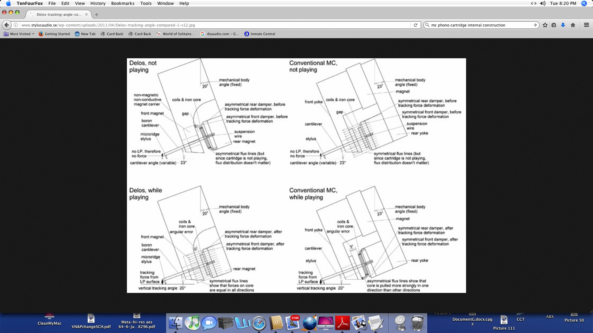

Here is a model of my MC phono cartridge. Please note: there is a piece of magnetic material that the coils surround that is NOT a direct part of the major magnet structure. This is what gets demagnetized.
John- Do you really believe that only one cartridge mfr realized that in play the magnet is in a different place than when "relaxed"? Also if you follow the magnetic fields etc. you will see its not a very efficient transducer.
If you look at how the active cartridge demagnitizer works it will "trap" the magnetic field into the armature as its field is relaxed, similar to how bias works on a tape recorder. Its not demagnitizing the cartridge. I would suggest using it with the stylus on a record.
