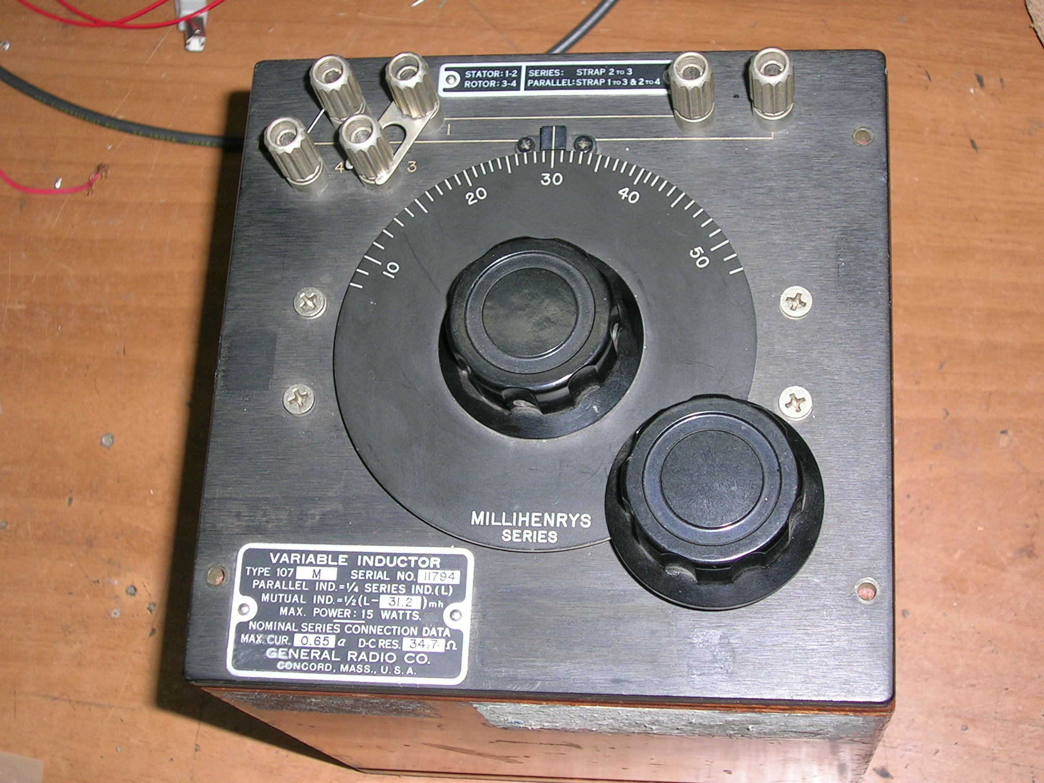

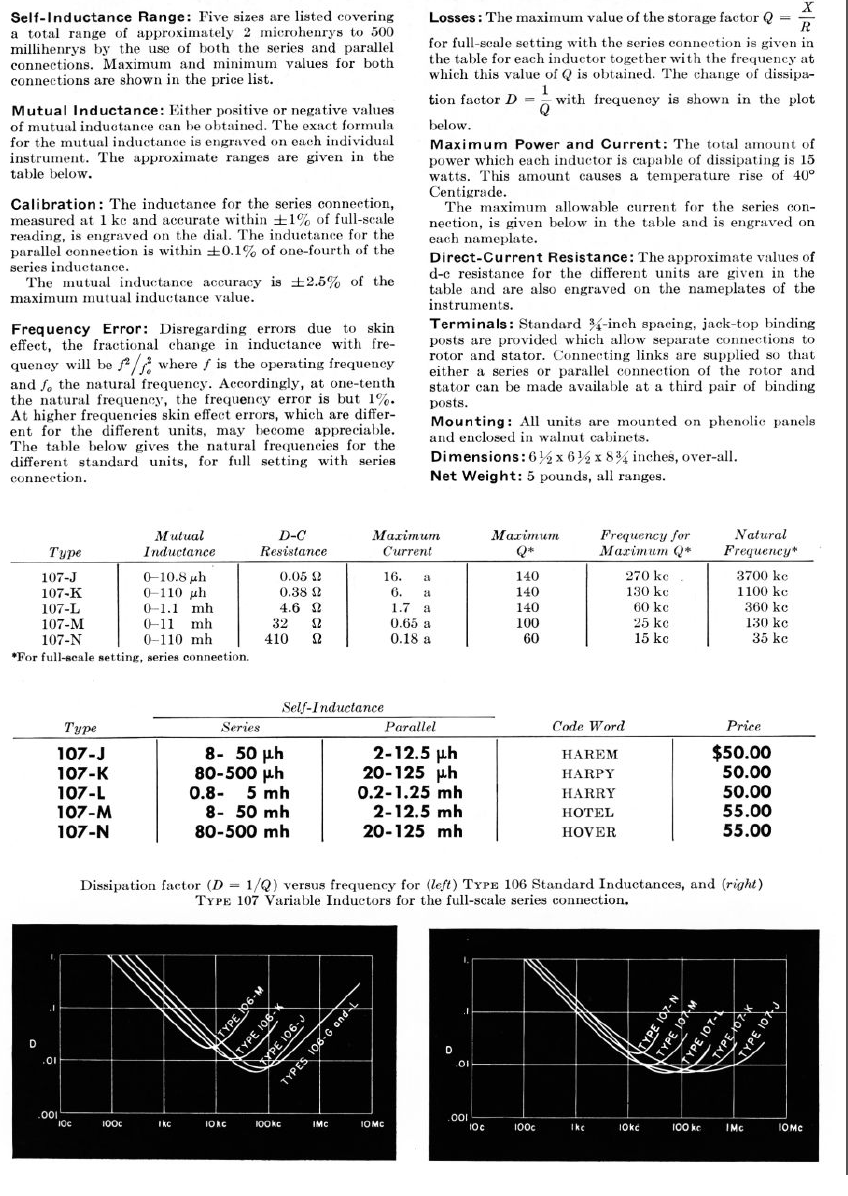

I have a variable inductor.... made this way but rotates within another. Cool thing.... just had to buy it even with no use for it. Yes, commercially made.
Something like this?
