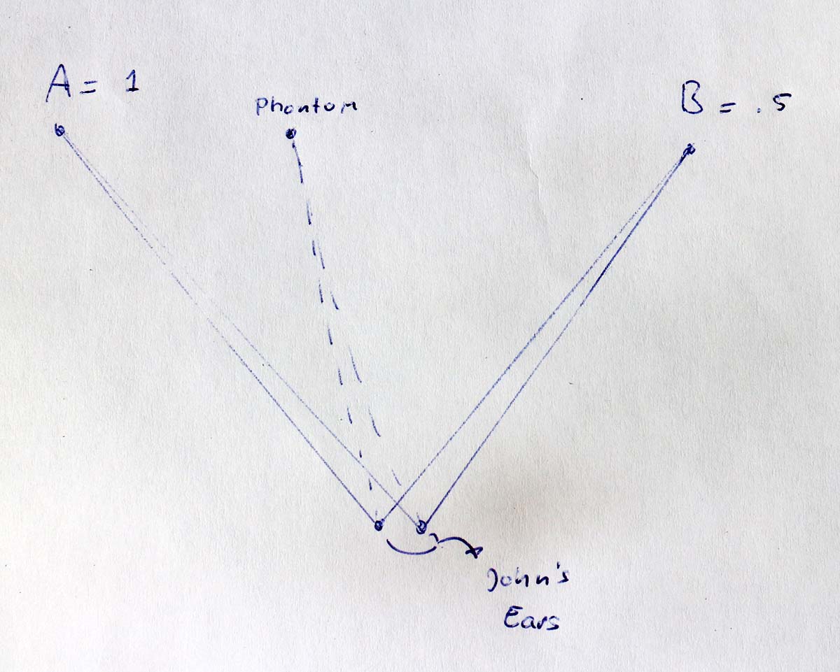

Blumlein showed that intensity panning, in this drawing full amplitude to speaker A and half amplitude to speaker B, will lead to the creation of a phantom image of which both amplitude and phase add up correctly at the ears of the listener. That is why imo he became known as the inventor of stereo; he was the first to prove this mathematically .
It is good to refresh your trig to calculate the phase shift at the listeners ears (if you are so inclined) for a single case. Blumlein wrote the derivation out and I remember having studied it when all such info came to us in paper form. Must be on the internet somewhere. Can´t find a link but would be thankful if someone would post one.
I ran the math years ago. For two speakers, there are 2 events which occur temporally.
1. When initial fronts hit the ears. Right to R, Left to L.
2 When initial fronts hit the opposing ears.
Given intensity only panning, at "1" there is no ITD to key direction but there is intensity difference. This does not occur naturally, is a forced condition we need to interpret.
At 2 (diffraction limited), the opposing ear hears the intensity difference, but now reversed. At this time, the brain has to distinguish the wrong intensity/direction cues, but they present an image symmetrically opposite the original. So, the brain does it's first come, first served thing.
What also needs to be considered it the way the intensity falls off with source. I've done the math for point sources (spherical propagation and 1/r squared falloff), line sources (cylindrical propagation and 1/r falloff), and planar source (no falloff near field.)
Additionally, I did the math to determine what differentials in intensity and timing would do to the positioning of an image in the soundstage. For example, how tight ITD had to be to maintain a positional accuracy of say a foot uncertainty when an image is 15 degrees to the side of center. I'll try to find some of the graphs, not sure which computer they are on.
edit: Needless to say, my math and understandings do not agree with Blumlein. There is no way to alter the actual ITD at the ears unless one is only considering sine excitation. I never consider sines in my analysis, as I rarely listen to them.

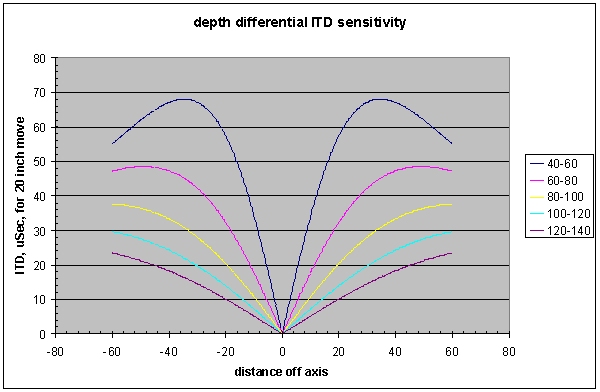

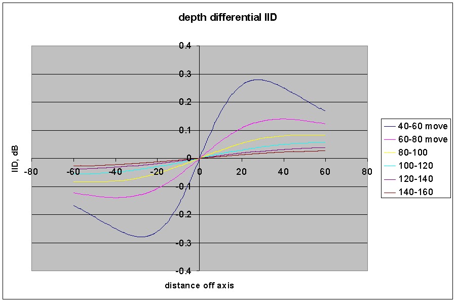

Ah, found a few. Did these back in 2005. These are for soundfield depth perception.
I think the depth differential IID plot uses a point source. ITD doesn't care.
These are the changes that occur when the source is moved by a distance from a specific distance. For example, a source 20 inches off axis 60 inches away will show a .1dB change if it is moved to 80 inches away.
For ITD, the difference will be 30 uSec for the same move.

Is the Blumlein analysis just for a line in the plane of the speakers? Effectively assuming you cannot get 3 dimensions out of 2 speakers?
Blumlein showed that intensity panning over two loudspeakers produces a phantom image which is correct both in amplitude and phase in both ears of the listener, also at off-axis listening positions. There is no information about hight or depth coded as such. Good gain jockeys know how to create those dimensions by tricking the brain by introducing HRTF-like distortions.
I suspect his analysis only works for one frequency at a time, and steady state.Blumlein showed that intensity panning over two loudspeakers produces a phantom image which is correct both in amplitude and phase in both ears of the listener, also at off-axis listening positions. There is no information about hight or depth coded as such. Good gain jockeys know how to create those dimensions by tricking the brain by introducing HRTF-like distortions.
I will have to review his equations and assumptions to be sure.
