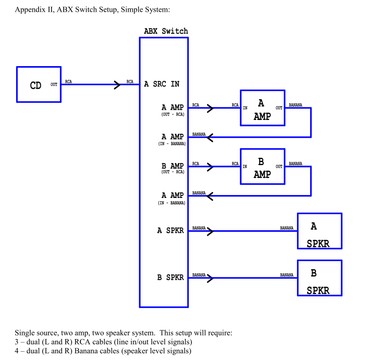

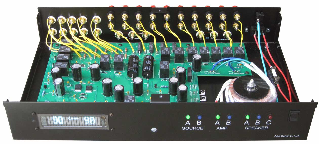

So lets have a really close look at the internals.
The ABX Switch was not designed to connect to maximum line level signals, it was designed to
“drop in” to a system set at normal listening levels (or slightly louder) and then attenuate those levels
slightly to achieve equal volume settings for all components. There are 96 different volume settings
maintained in the ABX Switch, a sub volume and a mains volume left / right pair for every possible
combination of source, amp, and speaker.
Yes, this 'individual' circuit path level control is mandatory.

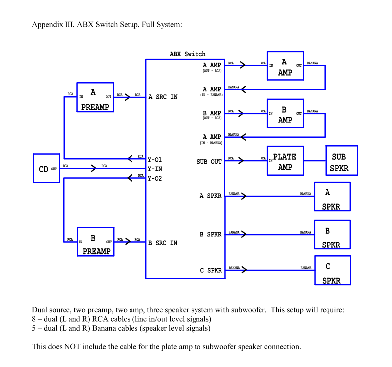

The “Y” RCA jacks form a simple splitter. Connect a line level signal to the center jack and you get two
duplicate signals on the jacks to the left and right. This is useful when testing two preamps or DAC’s…Not
really needed for testing power amps and speakers. There is a 10k ohm resistor between center jack and left
/ right jacks so isolation exists between the duplicate signals.
So referring to the second block diagram and the above description it seems that 10K series resistance is added to each preamp/loop feed....Hmmm.

So Mr VA, respectfully a very nice try but fundamentally flawed for discriminating fine differences because of the confounders outlined above.
I note also that there are no IMP/FR/SNR/THD/IMD specs for the controlled line level throughput.
Insertion of this ABX box is ipso facto too far removed from individual system testing, and from the lack of performance data available cannot be regarded as providing valid test results.
I note also that the proponents of ABX results do not quote the test conditions.
To ABX proponents, without full ABX test system disclosure.....
