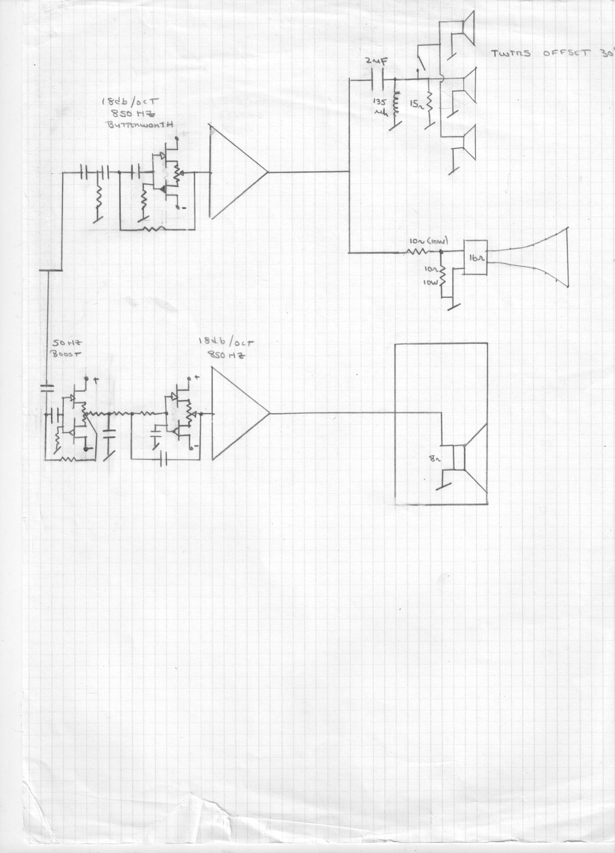

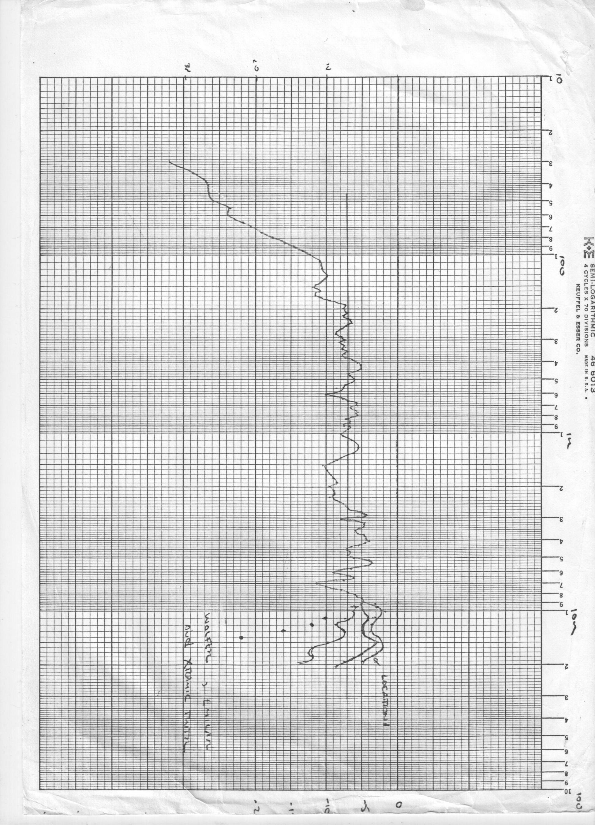

I once made a design similar to the M2 in the mid 1970's, but a 3 way with an 800Hz and 10KHz active Xover. It measured OK, but it didn't sound right, so I gave up on speaker design. '-(

No, the loudspeaker that John Meyer and I worked on was a 3 way horn loaded speaker with 3 separate amps (JC-3 for the tweeter) and a transient 'perfect' xover. We used a time delay for the tweeter (Electrovoice T350).
This design was separate from the one that John Meyer that I worked on in Switzerland, and started after he returned to the USA.
