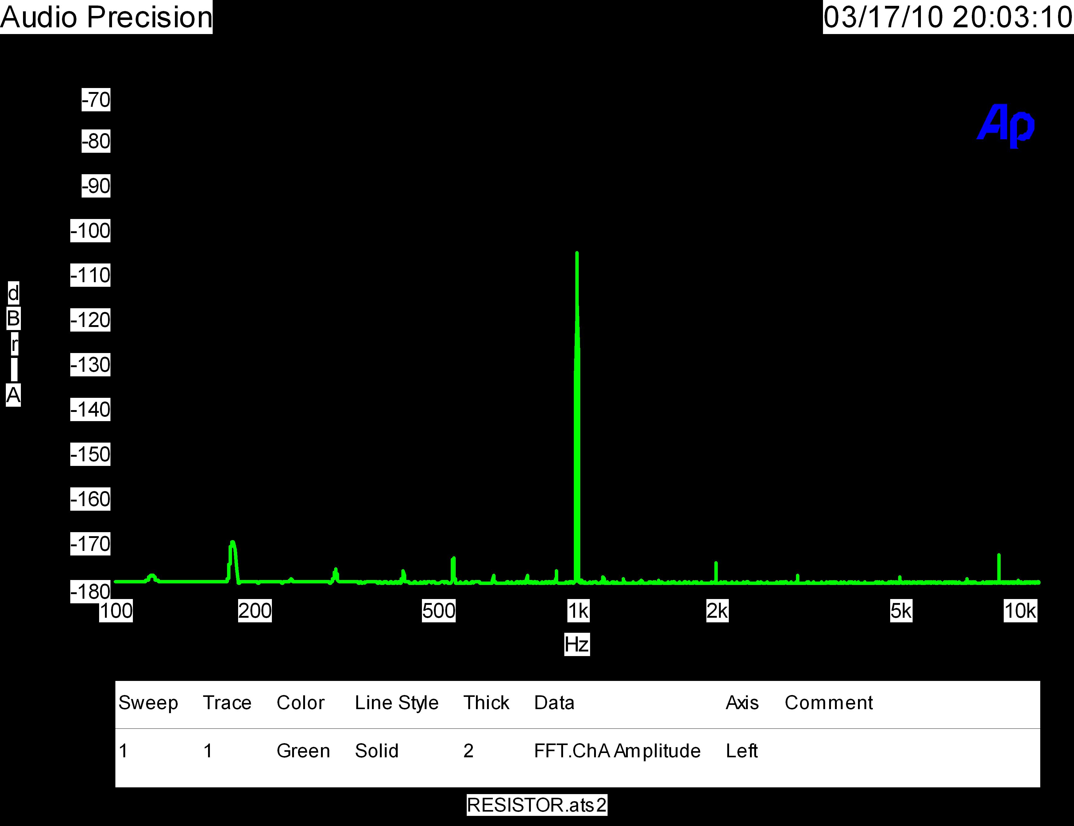

I owe you these two measurements. One is of a Mills 5 watt resistor the other of a Dale 1/4 watt metal film type (Green Curve). Both are measured at the same power. So when common sense says to use a higher wattage resistor to minimize thermal distortion in a feedback resistor, sometimes it just doesn't work that way. Although across families of the same process it does seem to be more in line with common sense. But does not exactly follow expectations.
For those who haven't been reading old posts the tallest spike is the 1k test signal that has been nulled. The rest is either hum and noise pickup or harmonic distortions.

Again Ed your logic escapes me. You compare resistors that might well have >100x difference in TC, who knows. I would not have any expectations beyond measuring the TC computiing the thermal properties of the resistor and making some kind of prediction as to what I should measure and then comparing an actual measurement. I have postulated several experiments to try and separate out the TC from true voltage coefficient of resistance. Of course us engineers are accused of having no curiosity.
BTW looking at that Dale plot you would have a hard time making an arguement for naked Vishays.

And to compound the TC issue, the last few decades they have been increasing the power rating of all resistors by increasing the alumina content, making them all run hotter.

We are not disagreeing. I don't understand your comment, do you think I am trying to provide misleading data? I ain't selling nothing. I picked the Mills 5 watt as that is touted as an audio resistor. 5 watt metal film resistors do exist but are not as available. I ordered a bunch of resistors sold as either audio or precision and tested them. So from my data set I showed that power rating alone is not a guarantee of lower distortion. And why use a 5 watt resistor when a 1/4 watt will do?
The Mills resistor is rated at 50ppm as was that Dale sample, so it was not apples to bananas. The interesting issue with the Mills was the third harmonic distortion. The voltage distortion does not change with frequency as does the thermal. Since I have not yet found in my limited testing any resistor that has second harmonic distortion not following predicted thermal changes, it may be the voltage effects show up better as the third harmonic levels. Don't know for sure, but third is certainly an interesting case.
The problem with just looking at tempco is that you don't really know thermal mass. (For those who don't understand this, a high thermal mass would take longer to heat and cool so the distortion would be less. This shows up in the previously posted 19 & 20khz IM distortion plots.) I would have expected a wirewound to have more than a film type, but the measurements show less distortion with the metal film.
So even with identical rated tempcos there are still significant differences in the thermal distortion as well as other distortions!
As to the Dale working as well as the naked Vishays, certainly seems that way, worse yet there is a 1.6 cent resistor that measures much better than many others!

Sorry Ed it's hard to have a discussion without all the information. It's perfectly possible for a resistor to have a voltage coefficient, that's just part of the equation. You still won't convince me these sub-ppm effects are audible in a controlled test. In this case you show <-150dB thirds.
