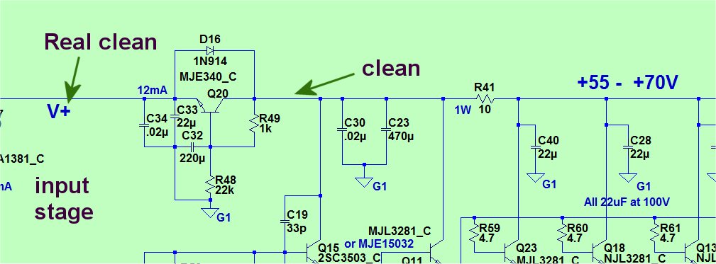

The issue with diodes that cause switch-off ringing is not that they will pump garbage into the circuit on the rails. The problem is they cause HF to be radiated in the wiring between the reservoir caps and the transformer secondary wiring. This can then possibly be picked up by the amplifier circuitry and especially so if we are talking small signal stuff.
However, the cure in all these cases it to snubber effectively.
Snubber paper -
https://www.google.com/url?sa=t&rct=j&q=&esrc=s&source=web&cd=1&ved=0ahUKEwjAutHfgIbNAhWLeT4KHRWlDIQQFggdMAA&url=http%3A%2F%2Fwww.hagtech.com%2Fpdf%2Fsnubber.pdf&usg=AFQjCNGf7gd2pGvl6aR7O-3if76UrugW4w&cad=rja
Cap types and more tips.
https://www.google.com/url?sa=t&rct...sg=AFQjCNGi7sQnpjJ5ZSJucr3vhn-lTJssdw&cad=rja
I follow these rules loosely , use .01u poly 250v caps.
Hagerman (first paper) , tested just the .01uF - satisfactory ...
If you DO know the inductance (in) your PS , you can calculate the R/C
like Bonsai mentioned. Hagerman called this the "crapshoot" ... :D
With a large PS decoupling bank , and simple cap multipliers (below).
Any rail garbage is nearly gone after C30/23. No matter what garbage
DIY PS I use , only < 2mV gets past Q20 (the multiplier).
Folded cascode current based input stages are unaffected , and a
>100db high NFB PSRR input stage is nearly immune.
Edit - you can also go "anal" and shield your trafo primary/secondaries....

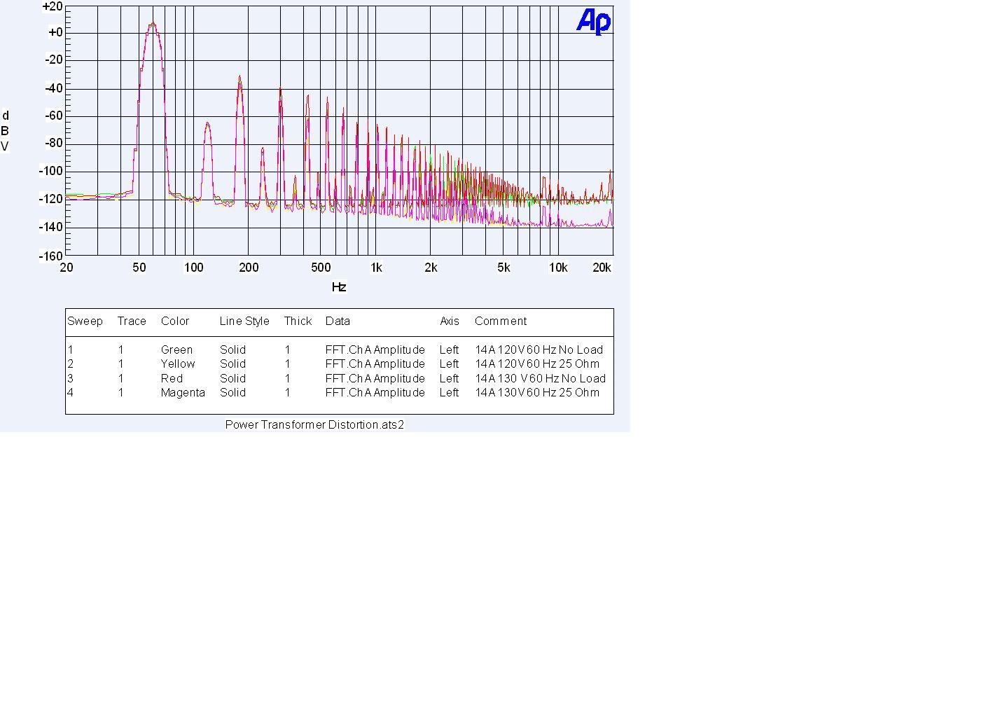

Attached is the noise just from a power transformer. It puts this out both as a voltage into the filter circuit that should clean it up AND as flux leakage that gets into everything from the chassis to any circuit loop.
Due to the Fletcher Munson effect you won't hear the line frequency, but the higher frequencies will mask desired signal.
So the hum is at full scale while you listen, your poor speakers. In this case let's say I measure the radiated SPL of the hum with no input what is it? Then I presume from your plot the 4k noise is -100dB below this. Now what is the typical SPL of the program content at 4k? Just asking for some numbers.
On a microphone preamp with 60 dB of gain this can be an issue if not acknowledged. Easy to fix. External power supply or internal with a subcase for the power supply.
Using the model of -3 dB / octave, the sensitivity on music is +15 dB. So the harmonics drop as expected, the hearing sensitivity increases by about the same amount and the signal drops by 15 dB.
I think that makes it clear that power supply issues may show up as a midrange issue before being obnoxious as hum.
