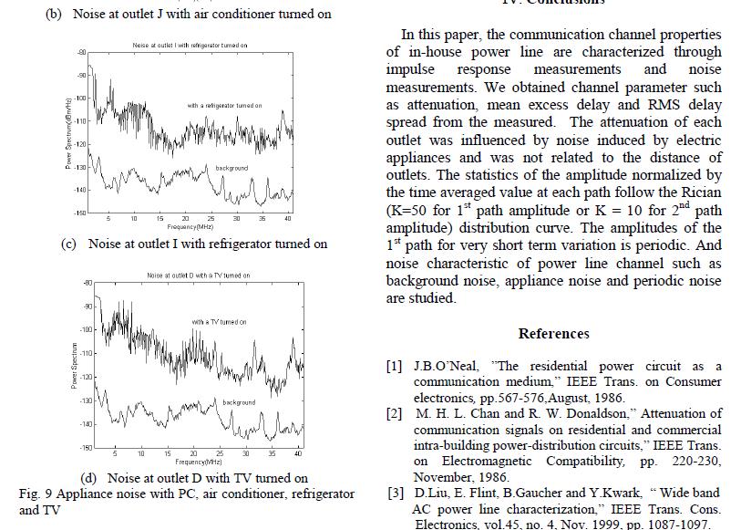

This is characterisation of power line for power line comunications? It is normaly that inductor impedance rises with frequency.

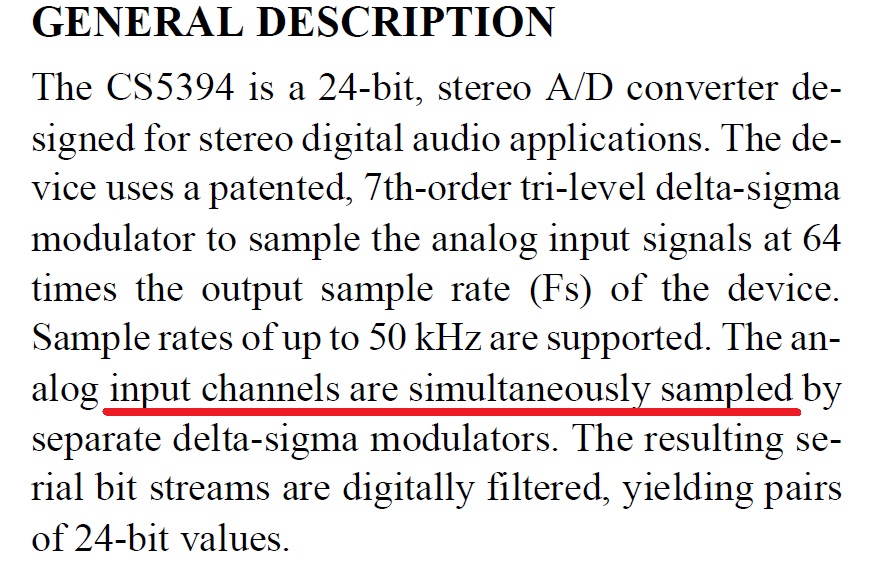

Modern ones all sample both channels at the same time. See example below.

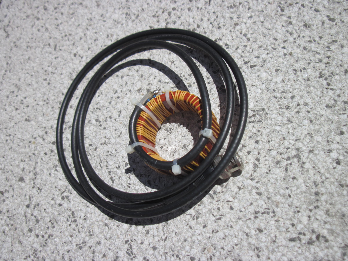

For those of us without the pre-requesite stack of instrumentation is there a (within forum rules) DIY friendly CM/DM measurement method out there.
Depends of the frequency you are interested in.
Basically you will need some kind of spectrum analyzer.
Common mode noise can be measured as the sum of all currents through the cable using an isolated current probe.
This common mode probe can be built based on a high u ferrite/nanocrystalline or amorphous toroid core. Wind 50 turns of enamelled wire, terminate with 50 Ohms and you have a wideband current probe that delivers 1V/1A.
This is my DIY current probe using a VAC core, operating in the range of 20Hz ~ 20MHz approx.
