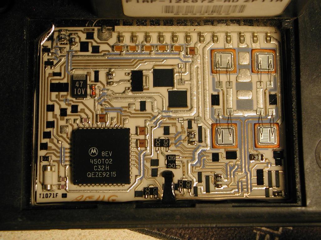

Not audio but the most impressive hybrid I have used is the ford EDIS module. I was a thick film hybrid potted in some sort of jelly protective goop. You could rework through the goop. Never found a reference for what it was.
Impressive because an auto OEM bothered to do that and it was so over engineered that they are almost indestructible. The off road crowd love them for engines that run underwater. And easy to drive from a simple micro. I can only assume that as this was Fords first foray into distributorless ignition they dared not mess it up.

Found a pic of the EDIS hybrid in its goop. I would love to find where to get the goop from as great for DIY automotive stuff. This was around 1983 it was released. I used have a kit car so finding things OEMs had spend $$$ developing to help get you running for a few $ in the junk yards was always fun.
Huge leap of faith from the single coil that went before!

I don't see any goop. Is that because it's clear?
If so, the IGBT modules I recently autopsied had the same stuff. It was a layer of gooey clear poured onto the chip/wirebond area, and then they floated a hard clear epoxy on top of that.
They use the clear goop to protect from enviro as well as dampen any vibration. Under hood is vibe sensitive, especially the aluminum wirebonds, and IGBT's are sensitive to lorentz forces on the bond wired during pulse operation.
Might want to ask an IGBT vendor what the goop is.

If you look closely you can see it. similar consistency to good pork pie jelly.
Good call. One day will find out as it seems to have many uses for the audiophool worried about vibration.

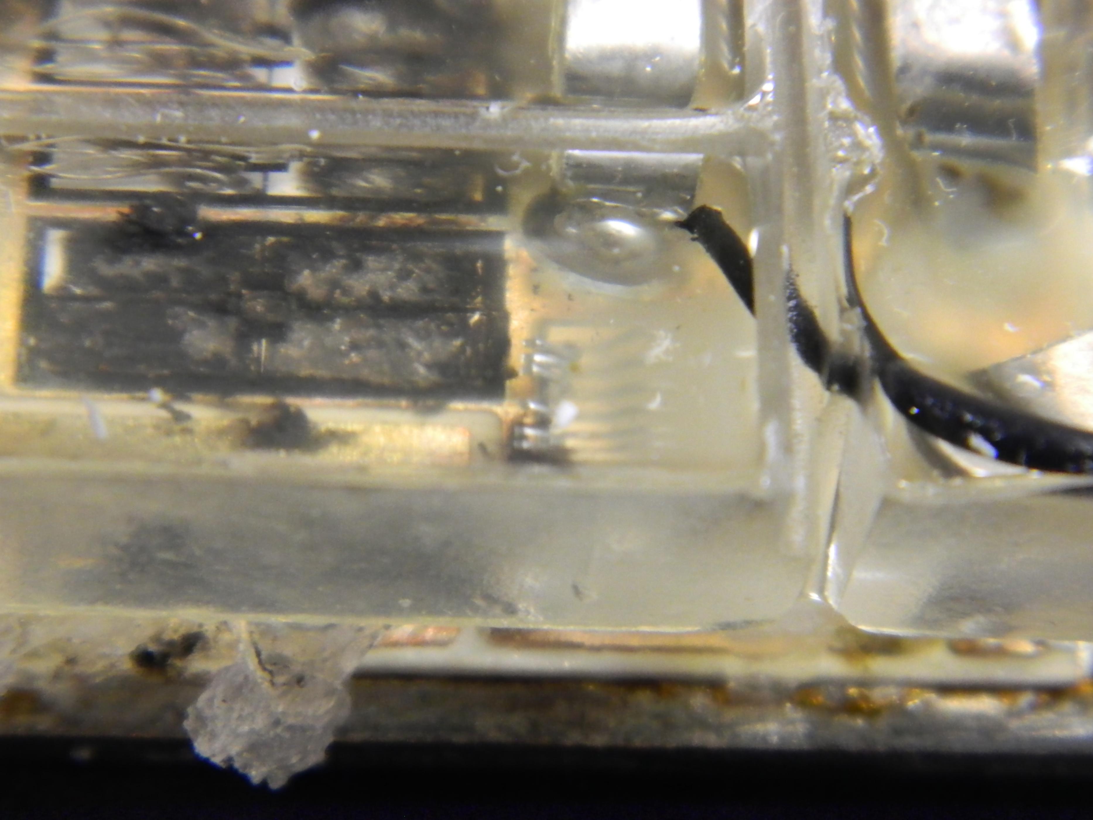

Here's a pic. The block of clear is the hard epoxy overcoat. The lower left "flake" is the goop that oozes out and is sticky to the tough (pardon the technical terminology). That's the stuff we be talkin bout.
This package is a 400 amp IGBT that "blowed up...sir". The base is nickel plated copper, the substrate is direct bond copper on alumina, soldered to the copper base plate.
The black looking thing is one of 4 paralleled IGBT chips. In this particular case, this unit is a quarter bridge IGBT, those black chips were destroyed during manu production test. They start with half bridge devices, and if one side blow up, they cut the wires and sell it as a single leg device with freewheelling diodes. We blowed up the other half. Then I had to determine how we killed it. These particular ones blew up because the unit turned off too quickly. As a result, the periphery of the chips died.

gelatinous silicone sounds more appealing than head cheese, somehow I try not to eat pure fat, but not sure head cheese would be a great material on our electronics devices!
Not sure of the chemistry behind a silicone that would be self healing if you cut into it to repair the electronic parts underneath, I'm sure that would be something Sy would know about. Sounds like a specialty silicone with very low cross-linking.
No, not in this case.The 'jelly' or goop is a silicon oil used for heat transfer.
-RNM
The stuff does not flow, there are no ports for fluid motion. It is not used for heat transfer at all. The device relies only on baseplate contact.
The difference between this stuff and the standard glob top is; this stuff is clear, it has a much lower durometer value, and it retains stickyness.
Otoh, CERN is considering the use of coolant flow for one of their IGBT applications. I have cautioned them on that because the device is designed as a bottom directed heat transfer path. Trying to use a laminar flow coolant on the die surface can cause cavitation during heat pulses, which will generate hotspots that the semi chip may not be able to overcome. To increase flow to turbulent to aid in thermal transfer and sweep cavitation bubbles can lead to flexure related wirebond failures.
