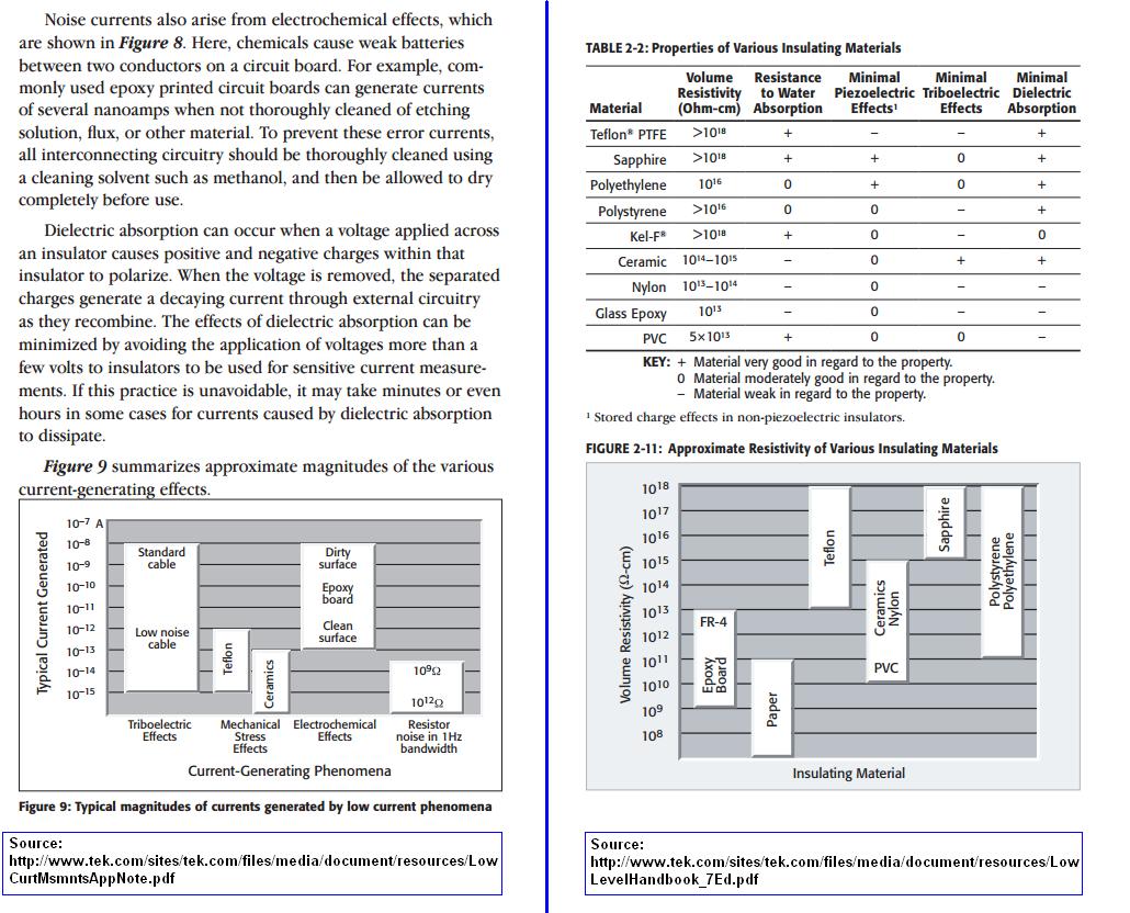

However, everybody seems to ignore the real reason we used Teflon for circuit board material: CIRCUIT HOOK
A term used by Tektronix denoting a problem that they had with their attenuators, etc using normal fiberglass board material. This was described in an article in an engineering design magazine about 40 years ago. It is related to DIELECTRIC ABSORPTION and the Dielectric Constant which can be very high value in cheap board material
It might have been a problem in instruments for measuring pA (or fA on clean boards)

Also as mentioned teflon is triboelectric. ADI had an ancient Analog Dialogue iirc that warned about minute currents flowing for substantial time if a teflon standoff were mechanically stressed. I believe that, similar to some extent to PCB material "hook", that these issues got better with better processing.

I can't find the Tek article either but this oldie but goodie does mention it at the end of the section on dielectric absorption.
http://www.analog.com/library/analogDialogue/archives/43-09/EDch 12 pc issues.pdf
But I mean, who would use precision analog techniques in a high end audio device when a something shiny will do instead?
That's got to be the article: W. Doeling, W. Mark, T. Tadewald, and P. Reichenbacher, "Getting Rid of Hook: The Hidden PC-Board Capacitance,"I can't find the Tek article either but this oldie but goodie does mention it at the end of the section on dielectric absorption.
Electronics, October 12, 1978, p 111-117.
Note that ADI describes it as a capacitance variation with frequency and most important below 10kHz:
"PCB 'hook,' similar if not identical to DA, is characterized by variation in effective circuit-board capacitance with frequency (see Reference 1). In general, it affects high impedance circuit transient response where board capacitance is an appreciable portion of the total in the circuit. Circuits operating at frequencies below 10 kHz are the most susceptible. As in circuit board DA, the board's chemical makeup very much influences its effects."

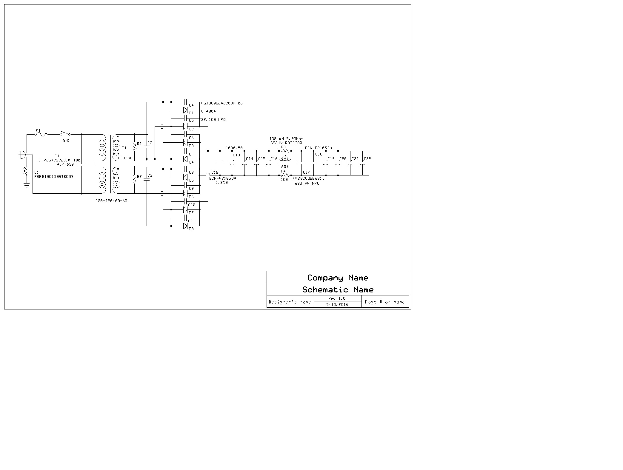

On an entirely different subject I have decided to simplify my power supply work to some simple projects. Attached is a schematic with values of a basic low noise DC power supply. The ripple should be .04 volts at 120 hertz and virtually no other AC power line noise that I can measure.
(This is part of the PC order.)
