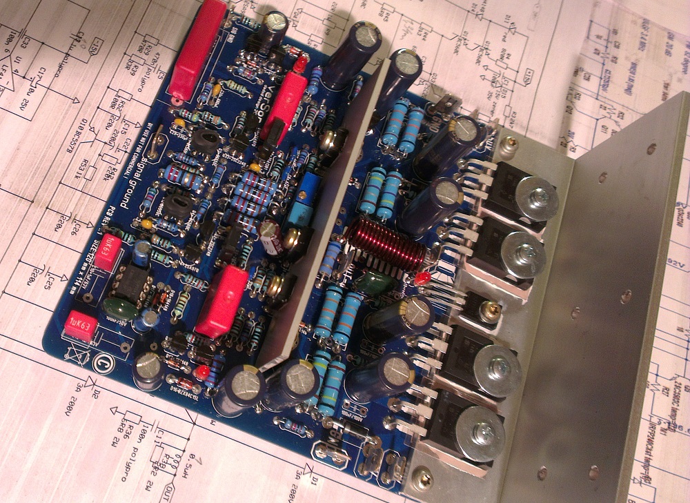

One very true balanced CFA power amp from input to output , with balanced in and balanced out , or with SE in and balanced out , developed by our member Polyphase .
http://www.diyaudio.com/forums/solid-state/270239-i-call-infinitron.html

Have you built that (post 80816) , Dadod ?
I had a similar one (infidel). It worked , had perfect 250khz+ square
waves ..... but was very touchy in the thermals.
I deemed it a failure , fell back on more "tame" designs (diminishing
returns decision - too many parts).

No, not yet, just unbalanced version without buffers at -in, a CFA.
It is really a good candidate for SMD and I don't see any thermal problem as the VAS and OPS are the same.
I never did any SMD layout (at least not complicate as this one), but I think, I have to start with IPS, VAS and OPS will stay THT.

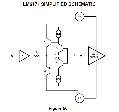

Good idea, because it does not. That's according to your own criteria, and also according with e.g. the LM6171 data sheet.
LM6171 TI data sheet said:The LM6171 is a true voltage feedback amplifier. Unlike current feedback amplifiers (CFAs) with a low inverting input impedance and a high non-inverting input impedance, both inputs of voltage feedback amplifiers (VFAs) have high impedance nodes. The low impedance inverting input in CFAs will couple with feedback capacitor and cause oscillation. As a result, CFAs cannot be used in traditional op amp circuits such as photodiode amplifiers, I-to-V converters and integrators.
Waly; You are reading Marketing spin to the old guys who cannot get their heads around a CFA.

But they are, just like an H-bridge input. Youse guys have to dummy up a little here. Waly is right buffered input CFA's behave just like VFA's input gm becomes fixed.
I had the privilege to listen and test this prototype amplifier. It was very stable under varying loads and output levels. And, it tests exceptionally good. same for its sound with both electrostatics and dynamic speaker types. ---- all without the extra VFA simulator/converter on the (-) input.
I wouldn't add the extra complexity unless there was some compelling need for a balanced input Z for a signal source.
Externally, yes. And for app engineers, yes. It wont matter much to them. But internally, the window of operational parameters, are still CFA. Unless, of course we redefine for simplicity sake that only the Z of the inputs ports defines a CFA or VFA..... which many are also trying to do.
