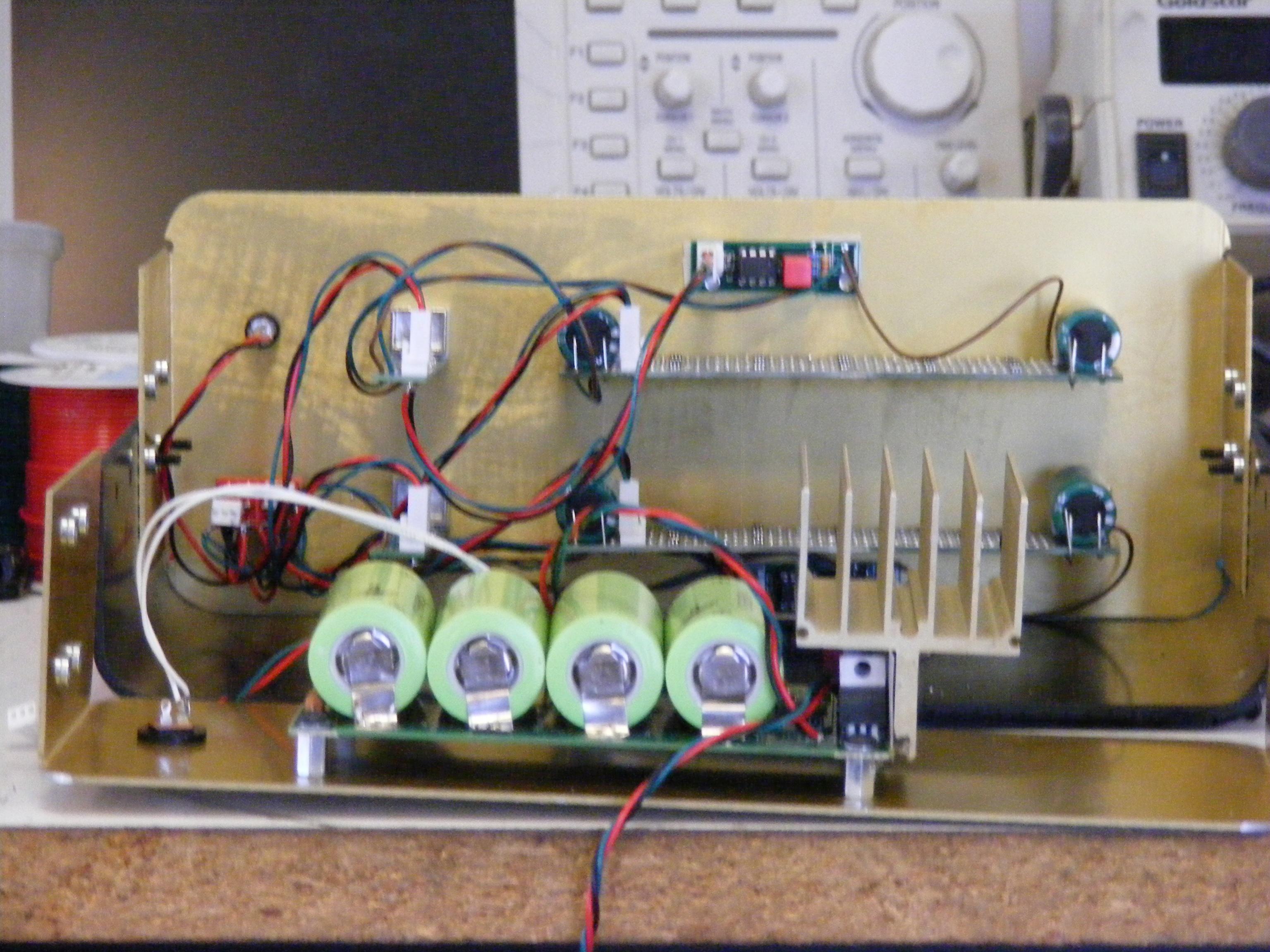

Now as to a low noise preamplifier Gerhard is studious and serious and has specific goals. I built one to play and learn. Still doing it.
One of the goals is to accurately measure battery noise. George cited a nice bit that uses TWO batteries so there is no DC issue and a bit more noise to measure.
Now I built a dead bang simple low noise amplifier using 25 TSH300 amplifier as they were cheap. I have four of these cards. Gerhard proposed that the reason I was not seeing 1/F noise was that with a gain of 20 (21 actually as it was non-inverting) my AP system 2 was the actual noise limit. So I added another stage for a gain of about 5 to bring the total gain to 100. I also added a servo based on an OPA134 (have bunches) with a 1 Mohm resistor and 4.7 uF capacitor. This takes care of the DC offset that changes with source resistance due to the high input currents (relatively speaking) of the preamp. Testing this out seems to give me a bit better than 6 dB less noise than a 10 ohm resistor. Input impedance seems to be around 600 ohms at 1 MHz.
Now I did some measurements before the KD2650M1A 4 cell battery pack discharged enough for the protection circuit to open. Up for today is to improve the recharge circuit. I originally thought a low current float would be fine, but that takes too long for my patience.
The under design, construction and testing input stage as I briefly mentioned is a transformer or more specifically a magnetic amplifier. This requires some support circuitry besides a primary and secondary winding. There is a tertiary winding driven by a very slow low noise high current and passively filtered amplifier to correct for any DC on the primary. There is a quaternary winding that is used for HF bias.
Then with a dual channel amplifier I can use a multiplier on the output to get additional correlation. Should be interesting to see how low in the dirt I can go.
As to thermal effects, my LF cutoff is .2 hertz. So hopefully the room temperature doesn't drift that fast.
Now even where things are now it should be possible to measure battery noise. It seems that the sealed lead acid batteries can vary quite a bit as to noise level, so I will order in a bunch and compare them to the used ones I have about.
If I get around to it I will post a schematic of the project to date.
I am curious to see if I can get below 1 pV/rtHz.

No. The active electronics are a bit above 100 pV/rtHz, a simple transformer gets that to 10's and correlation should get me to 1's.
Attached picture of the inside. Note the batteries, power supply regulators +/- 2.5 on heatsink, +/- 5 no heatsink, main preamp, second stage preamp and DC servo.
Don't forget to call the LHC and Arecibo people after succeeding in this endeavour. 10pV/rtHz before "correlation" is 6 milliohm, quite a hell of a transformer that needs to be air core (nice antenna), otherwise the magnetic core Barkhausen noise will kill the performance. That's before any considerations of contact potentials, thermal (gain, noise) fluctuations, etc...
1pV/rtHz is about 4 millimeters of a 1 sq. mm copper wire, good luck with the interconnects.
Or about 6 feet of 10 gauge. Only need 2 feet for the primary.
No, that's about 5 sq. mm, 20mm length for 1pV/rtHz, there.
6 feet of AWG 10 is 6 milliohm, that is 20pV/rtHz, 20 times your noise target.
Obviously we are not communicating.
Vn(RMS)= sqrt(4*KB*T*R) or sqrt(4 x 1.38e-23 x 300 x .006) or about .13 x sqrt(.006) or 10 pV
Now two transformers with a 2' primary would produce about 6 pV/rtHz or 8 pV/rtHz if added. But we are multiplying noise. So for random numbers around 6 x 6 would cluster about 11 not 36 so about 2 pV result.
