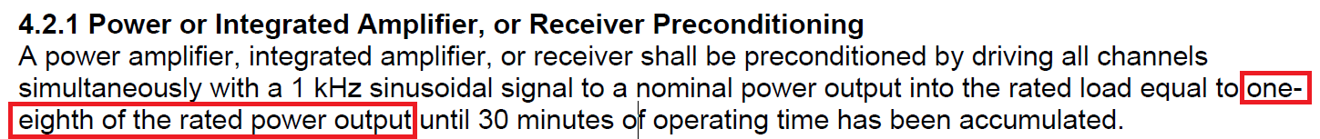

And wasn't the 1 hour @ 1/3 power a mandatory test for certification?
It was a worst case, based on a time long ago when the crest factor of music was not taken very seriously.
No, 1/8 for 30 min
No, 1/8 for 30 min
The 1 hour test was in the original IHFM-A200 (1958)

The 30 minute test is a fairly recent (Year 1999) revision by the FTC:
https://www.ftc.gov/news-events/press-releases/2000/12/ftc-approves-amendments-amplifier-rule
"The Commission subsequently issued in the July 19, 1999 Federal Register a Notice of Proposed Rulemaking (NPR) that solicited public comment on specific proposed amendments to the Rule to:
reduce the power output requirement during the one-hour preconditioning period from one-third of rated output to one-eighth of rated output, and grant testers of self-powered subwoofers the discretion to choose the frequency of the test signal to be used during the preconditioning period;..."

The 1/3 power test is still the one to use if you want to be sure all is good with the temps.
But the teeth have been pulled out of that test with 1/8 and the new wording.... now a worthless test only suitable for boom-box and cheap receiver mfrg. Which i guess is a large market.
I would still use the 1/3 test conditions for really 'serious' amp design/building.
