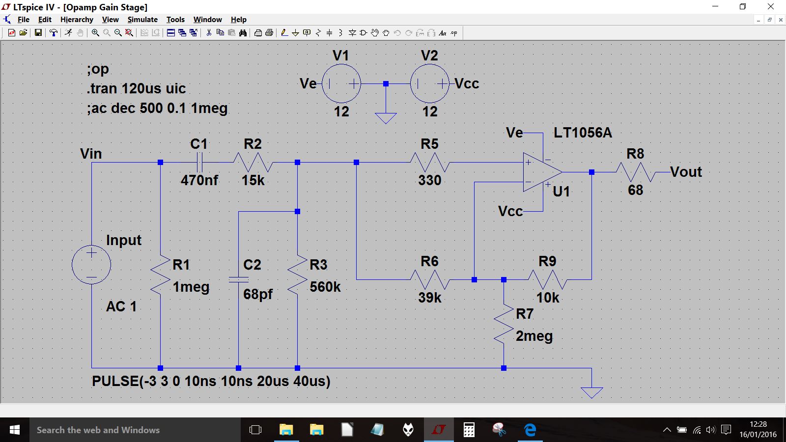

Why would anybody want to do that, save in case of instability? Is it because, if used normally, most 8 legged critters produce distortion well below the threshold of audibility? And increasing noise gain brings out the good stuff?
Nelson has advocated the technique of increasing noise gain for better subjective performance. This was quite some time ago though, and we have better devices today. Post #18 here,
http://www.diyaudio.com/forums/solid-state/6558-opamp-inverting-input-sounds-better.html#post67880
This is an old example of mine where R6 alters the noise gain and R7 allows gain above unity... all text book stuff.

Is that a "T" feedback arrangement?
Could you explain the gain?
The gain of the opamp section is standard opamp theory where G= (R9/R7)+1 Altering R6 doesn't materially alter the closed loop gain.
The filter network in front of the opamp adds a miniscule amount of attenuation of course.
Here is the file if anyone wants a play.
