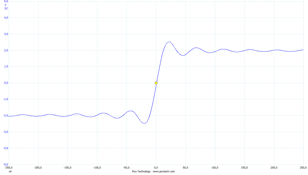

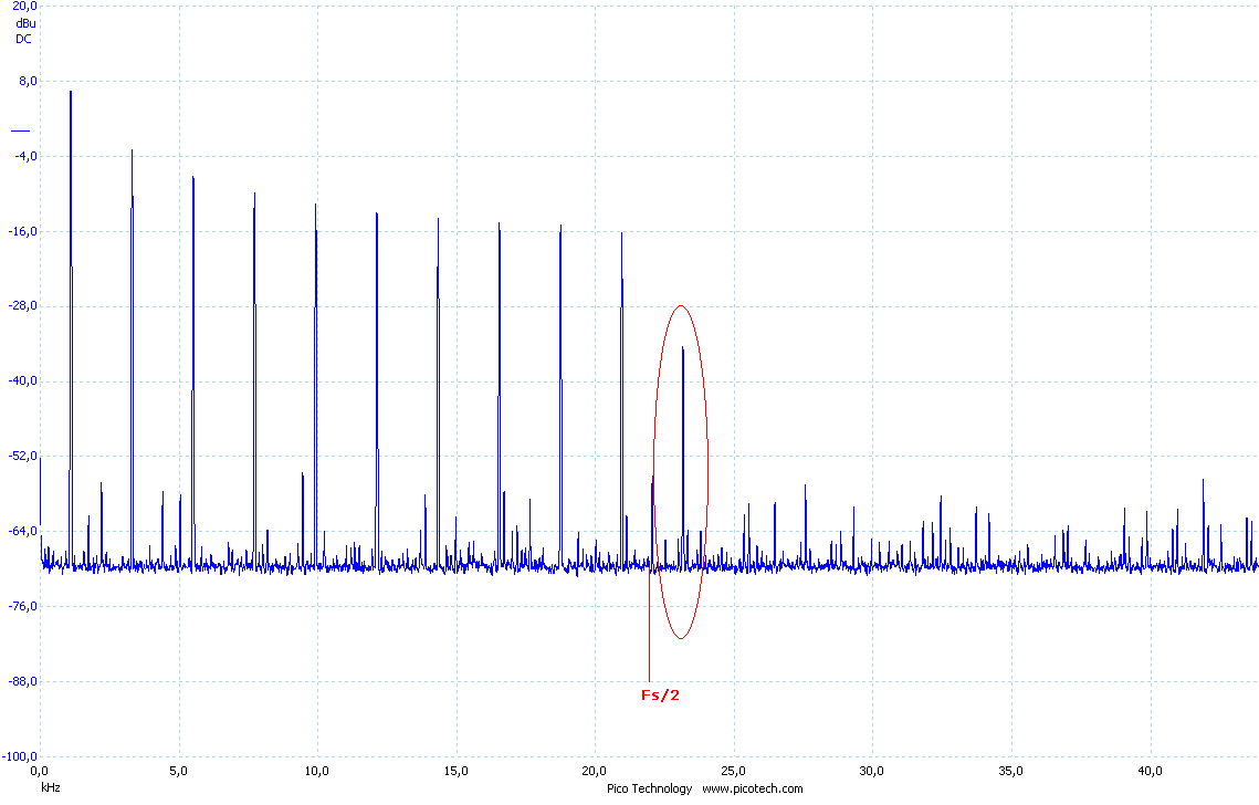

Hey George, what is that square you are showing?? Do you have some AC coupling capacitor there or what is going on??
Forth attachment is same CD player playing a 1kHz SQRW –6dB FS generated through Wavelab at 44.1k/16bits. This shows a bit more extended BW (21 harmonics) compared to Pavel’s (19 harmonics) .
No wonder, my square has had 1102.5Hz so there is only 19th harmonics . 1KHz square would definitely have 21st harmonics up to Fs/2.

Sorry George that it took me some time to concentrate on your measurements. But you have the point, testing with that square will show DAC filters behavior. There should be nothing above 21kHz, i.e. nothing above 19th harmonic for that 1102.5Hz artificial square. But it is definitely not the case in the real systems and it will differ product to product.
