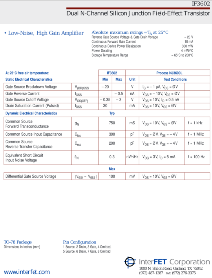

From the data sheet, I suppose the 1/f frequency is 99.5 Hz or so :)
Not really interesting when you are into 1/f.
JFET manufacturers seem to abhor data sheets. Yes, that's all.
regards, Gerhard
regards, Gerhard
I seem to recall that Danyuk measured a rather lower corner for the BF862, but I would have to dig out the article he did to verify this. But you are right, specs on FETs are meager.
