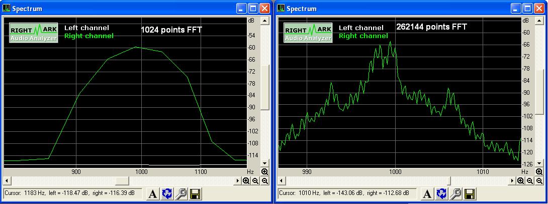

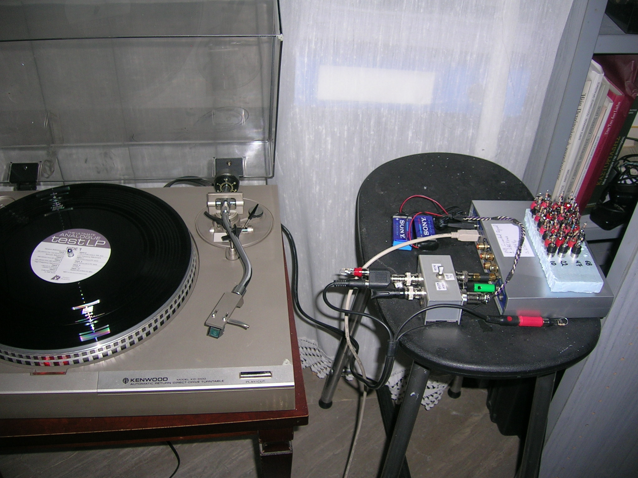

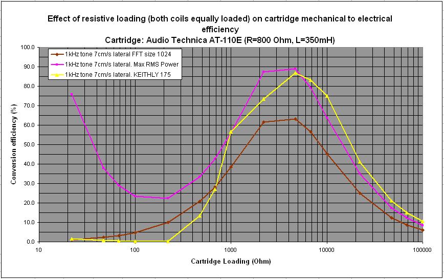

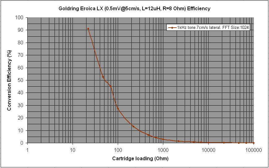

Scott and Ed
The way I thought as a good one for estimating mechanic to electric efficiency gives plausible results with an MM but close to the edge with an MC cartridge. (Edit: The Eroica is with Neo magnets )
With both cartridges, efficiency seems to peak with an ohmic load equal to the coil’s impedance.
At the recommended loading (47k for AT-110E, 100R for Eroica LX), efficiency seems to be close to 25%
I measured the cartridge output through an AD620 either as an x1 buffer or as a x53 flat preamp.
Good resolution and SNR with tone tracks was achieved by low resolution FFT (1024points) analysis of the recording. With higher resolution FFT, the problem of multi point peaks (it’s the medium) makes comparison btn different recordings difficult.
George

Scott and Ed
George, it's been a while. I thought the conversation was about damping via motor assembly over a large range of frequencies. Like does driving a short do anything for a high frequency cantilever resonance.
