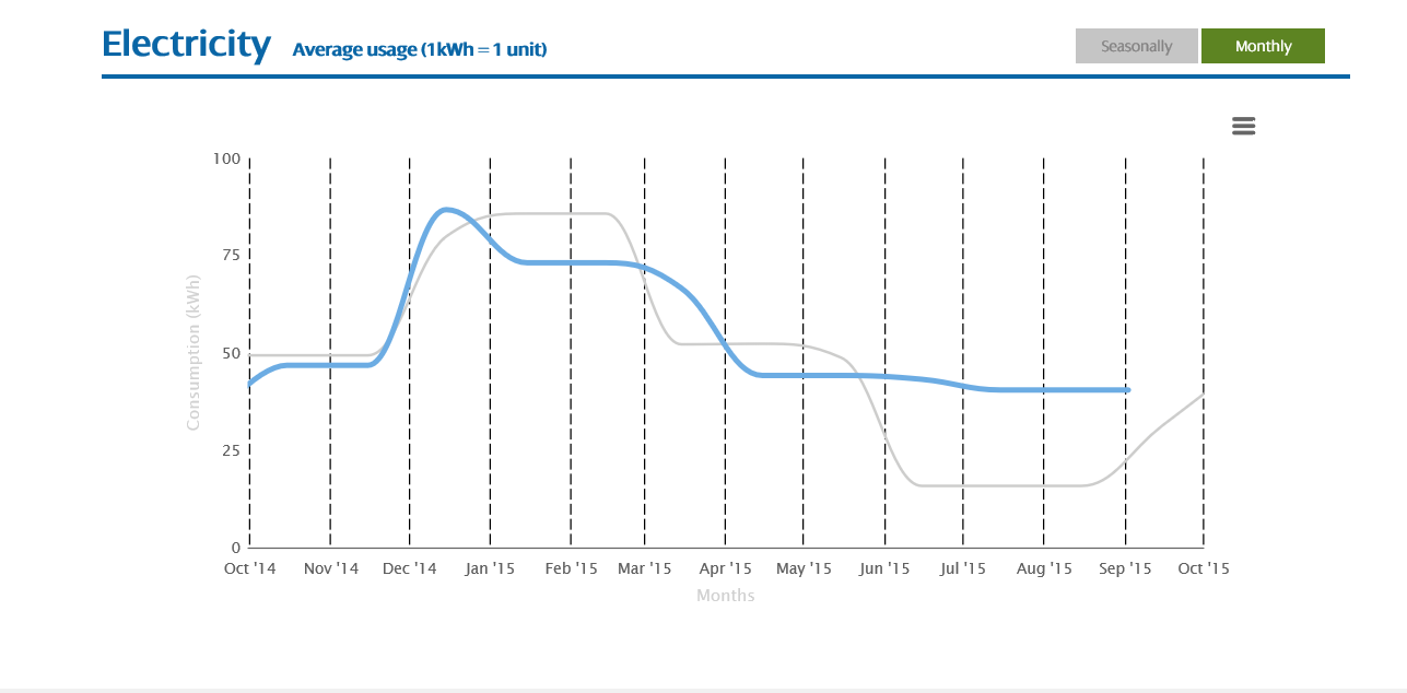

I just got my electric bill.... HVAC is all electric..... 25 dollars for the month. Aint solar grand? Granted i am not there BUT I do have a pool pump running hours per day and a few other things.... never been that low before solar. I also have 6 inch walls, lots of insulation etc etc.
However, for the almost 3 months i have been in my Asia condo.... the costs are super low. $3 for a water bill? Even with A/C running 24/7 the electric bill is like $80. etc.

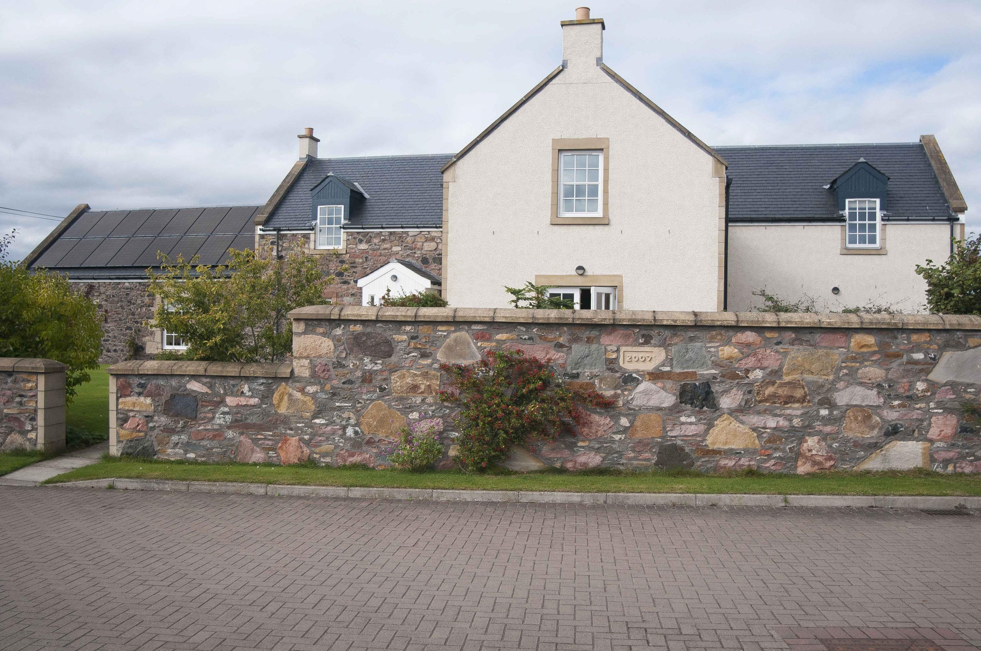

The old bit on the left is my listening room - and family room, a converted farm building. behind the external wall is a 6" blockwork inner wall with 10" stand-offs to a plasterboard finish. A fortune's worth of 8" double foil closed cell insulation board behind that. The roof has 6" similar board between the roof timbers and 18" fibre over the ceiling. A very easy room to keep very warm in the coldest weather. It is almost too damped sound wise and has a couple of nasty standing wave frequencies, tamed by 1" wool felt behind many pictures. The jail wall was built when we moved here. New stone from a local quarry hand split and built by a local mason.

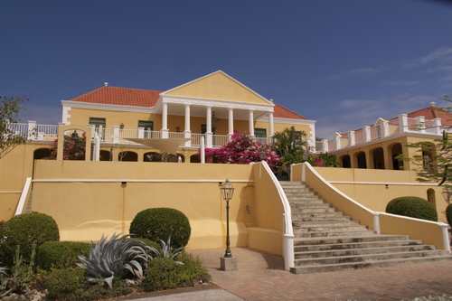

It is not subjective, the asphalt/concrete will go way hotter than ambient air, think walking barefoot on sand at the beach. Concrete cities accumulate a huge amount of energy during sunlight hours. A lifted house on Curaçao remains a lot cooler than a regular one, not just because of the wind blowing through open doors/windows, but the house itself becomes a fan-blown heatsink.
The fanciest are on top of a hill And raised (1m thick and sand-filled walls). Overthere, life is All about wind, the reason why everything has wind-related names. Right side is called the upwind area (Banda Ariba), left side is downwind (Band' Abao)
Very nice :)
And the panels are a good aesthetic match too, unlike some of the monstrosities that often seem to grow on roofs around here.
