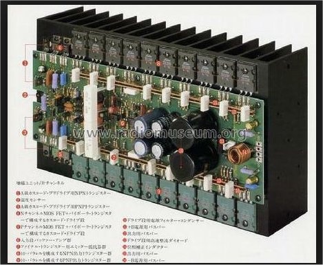

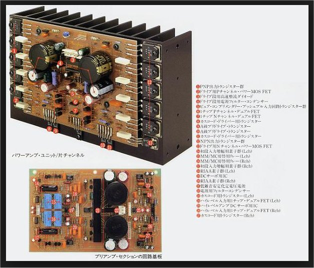

Accuphase ...
REAL good designs.
I was inspired by them as much as H/K.
E and P series (below) , similar to my slewmasters with fast
Sanken or toshiba EF3's driven by a CFA.
The new M series .... Accuphase Laboratory, Inc.?M-6200
is "scary power" ....
PS - I've auditioned the E series , as well as the H/K990 (VFA).
BOTH are impressive amplifiers despite being VFA-CFA.

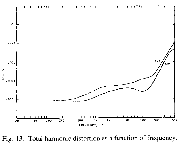

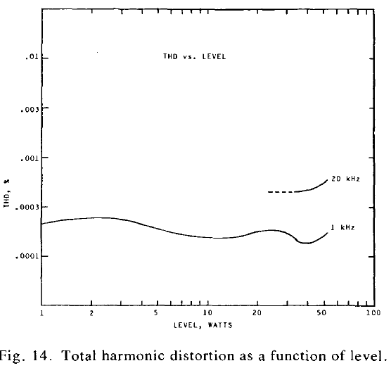

This may qualify. >300v/us SR. current-mirrors... uses and needs complex error-corrected OPS... DIY dont need the error-correction circuitry to cancel distortion. Compensation a bit tricky. Never the less, all the good stuff except the dynamic current on demand. It also isolates the Vas well from Load. Important. V.Good VFA design. As are recent OS and others not using error-correction. I used to think error-correction was going to be the only way to get such low distortion..... but now we dont have to. I have never heard it under dynamic playing conditions.
THx-RNMarsh
What is the design solution with VFA that will cause this dynamically changing distortion to be a constant, unchanging and at very low level... virtually unchanging with freq and power and load.... a straight line across the bottom of the graph (dotted line)? Do it for 200W/8
THx-RNMarsh
Put a tube buffer in front of a very linear amp. All you will see is the distortion of the tube buffer. Any amp that has this distortion profile is essentially doing just that, just without being obvious.
Usually when you get an amp where the distortion is level with frequency, it's not because it doesn't generate frequency-dependent distortion, but rather that is swamped by a source constant distortion.
The same is true of a "monotonic" harmonic spectrum. Say that an amp has H2 at -70db and H7 at -90db. Then compare that with another amp that has H2 at -110db and H7 at -100db. Is the second amp worse because it's not monotonic, or better because H7 is lower? If monotonicity is more important, then would the first amp still beat the second amp if the second amp had a tube buffer in front of it?
I see people rejecting the second design all the time, without even realizing that the high order harmonics are in fact at a lower level. They assume without paying attention to the scale that the first amp is "smoother" even though it actually has more high order harmonics.
