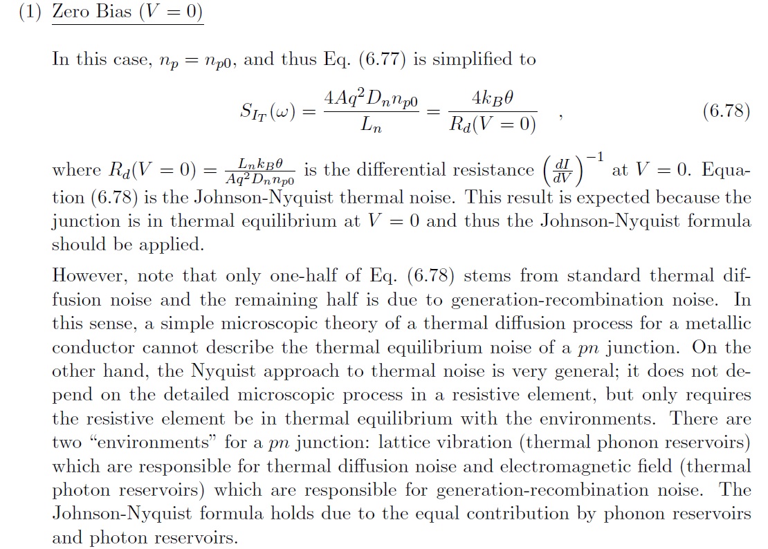

I seem to remember that the equiv. resistance of a junction has only half-thermal noise,
as if the resistor was at 150 Kelvin typ. Must search the text book.
Gerhard

Thanks.
Very interesting remarks about the sub-shot noise of emitted photons on page 31, referencing Yamamoto.
Because of charge-pumping effects (as opposed to mere displacement currents) in the Reticon arrays, of opposing polarity to the anticipated photon-induced charge signals, and because my pulsed-reset preamp could only reset for one polarity, I had to puff some photons on the array from an LED. It's interesting to know that the ~80k photons didn't degrade the noise quite as much as I thought they must have (assuming full shot noise).
