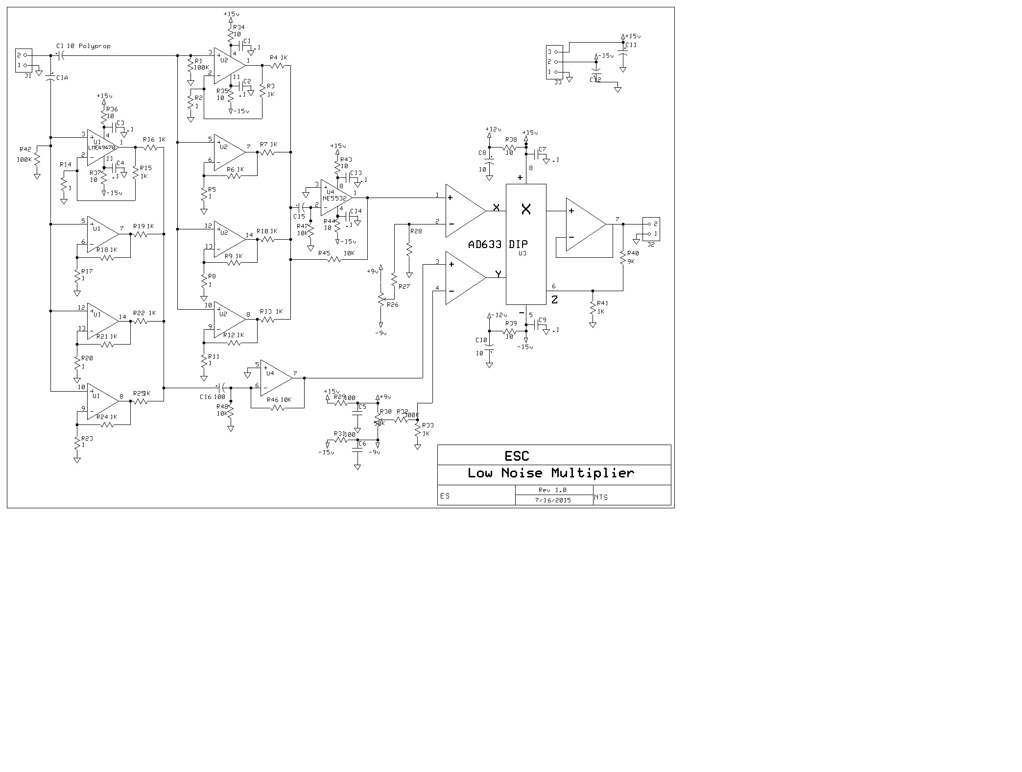

I just tried out my low noise amplifier. A few tweaks to the original design. Input amps are now LME79740 and second stage NE5532.
Shown are the input shorted, with 10, 100 & 1000 ohm terminations. Powered by 9 volt batteries and no case. Should be able to improve this by at least 3 and maybe 6 db!
Do you have any idea why the noise of the 1K termination rises again towards higher
frequencies? ( 100 Ohm also, but less)
In my preamp, I have a switchable termination of 60 Ohms directly in the shielded box.
That gives a very convenient absolute 1 nV/sqrt Hz calibration line on the spectrum
analyzer display, and it is completely flat to 1 MHz where the gain starts to drop.
cheers, Gerhard

I wish TI provided a plot of input current noise versus frequency for the LME49740 (I assume 79740 was a typo).
Not a particularly good choice for MM with that current noise, despite their application example!

Yes I found a shorted trace and the issue is now gone. I figure the 100 ohms is 1.3 nV/sqrt Hz.
I get nowhere near 1 Mhz. More like 50,000 Hz. But I strongly suspect I can get noise around 100 pV/sqrt Hz 1,000 to 20,000 hertz. This was more a test of concept with the multipilier.
I think you are still the champ.
Attached current schematic.
