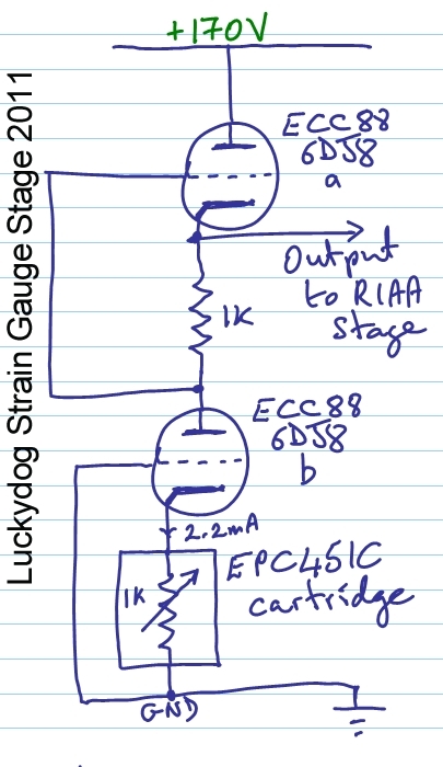

To illustrate the principle, here's a minimalist preamp I devised in 2011. It's a sketch for a strain gauge preamp input stage - just one valve and one resistor.
Bias current for the strain gauge cartridge is the standing cathode current.
If one can tolerate the natural discrepancy between SG and RIAA eq, it has enough gain to be complete if the following amp is ac coupled and high input impedance !! Just one valve, and one resistor.
It works well, BTW.
So what happens if a standard MM is substituted for the SG cartridge ? Will the universe collapse to a singularity ?
It works well, BTW.

Of course the strain gauge transducer has to have the bias current to operate at all. The MM cartridge doesn't need it and it may well be deleterious. In any case the cartridge was developed assuming zero d.c., and unless we wish to suppose the designers don't know what they are doing (a common diy aberration), it's prudent to avoid it.To illustrate the principle, here's a minimalist preamp I devised in 2011. It's a sketch for a strain gauge preamp input stage - just one valve and one resistor.

Well a few mA is a limit, not a target ! One might minimise it out of caution, but even a few mA (a volt or so drop) represents perhaps only a few mW of power total into the coil. IME it is typically tolerated well and I have not damaged a MM cart during testing this way. Neither have I found it to be typically deleterious to performance in any measurable or audible way.A few mA? For a typical MM cartridge this would require a few volts across. Not on my watch.
Yes, but in practice any such assumption typically doesn't appear to matter, and in the case of some generators such as MI one can readily see why..........bcarso said:In any case the cartridge was developed assuming zero d.c., and unless we wish to suppose the designers don't know what they are doing (a common diy aberration), it's prudent to avoid it.
Point is there's an upside opportunity by way of fresh circuit topology, especially in low impedance configurations, if dc is tolerated well by the cartridge. Even in conventional circuits, saving input coupling C is an immediate opportunity.
In MI carts, which many MM generators are, one can readily see why there is no dc effect on static position. I have also tested true MM carts and not noted static offset even at a few mA of coil dc.scott wurcer said:Has anyone done an experiment to actually measure the coefficient of electro-mechanical reciprocity in a MM or MI?

While I'm all for fresh circuit topologies, endorsing ones that pass bias currents through the cartridges seems just headed in the wrong direction. And we don't need coupling capacitors to begin with.Point is there's an upside opportunity by way of fresh circuit topology, especially in low impedance configurations, if dc is tolerated well by the cartridge. Even in conventional circuits, saving input coupling C is an immediate opportunity.

I see no basis for that, either in theory or in my experience of testing typical cartridges. I accept it is iconoclastic, and contrary to common lore, but that hardly seems a sound basis not to consider it on merit. It stands scrutiny - really. What tangible downside can there be in a MI cartridge, for example ?While I'm all for fresh circuit topologies, endorsing ones that pass bias currents through the cartridges seems just headed in the wrong direction.
Passing dc is not mandatory for transimpedance loading, but it certainly opens fresh topologies..........
