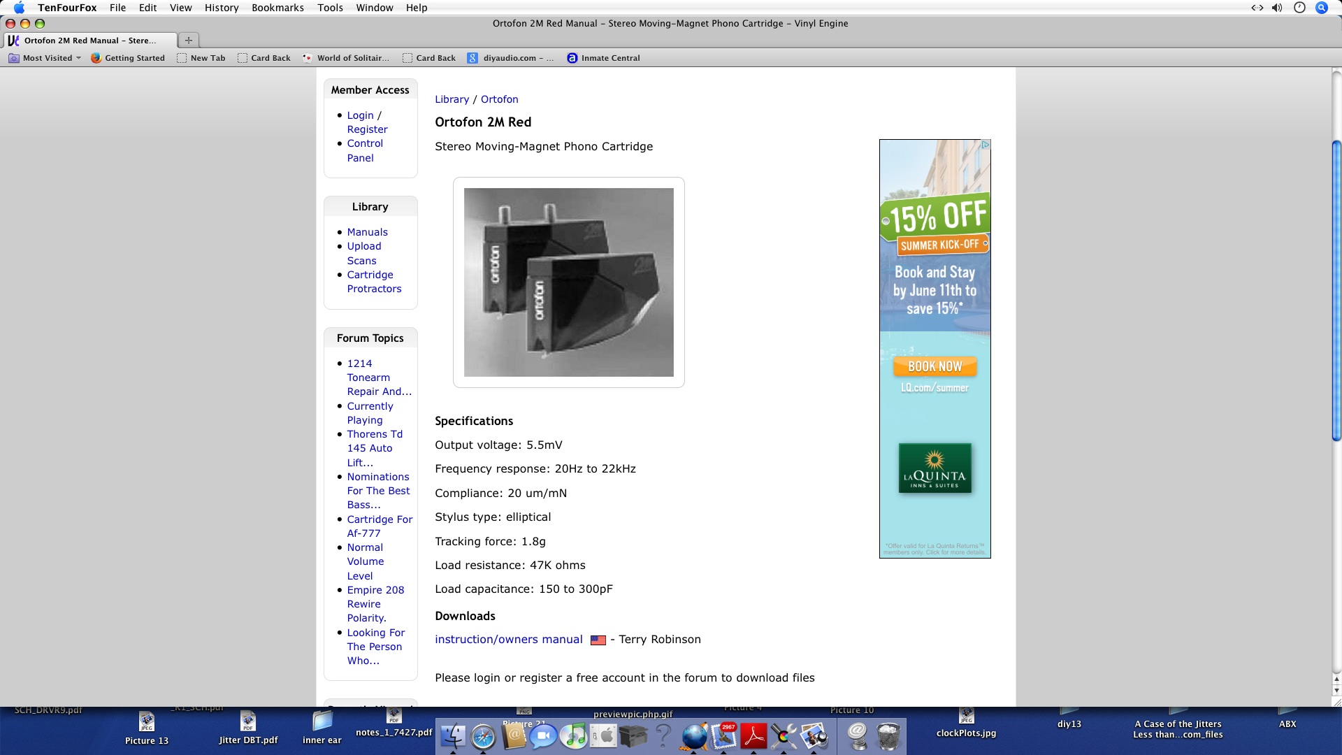

The mismatch of the week:
An Ortofon Red MM and an SME309 tonearm. $100 for the cartridge, $2400 for the arm. Maybe a better cartridge would have a lower compliance, and raise the resonant frequency to something more appropriate.

IF you are using a MC cartridge (with modest compliance) and a good (robust, but low mass) tonearm, then run all out! You only have to worry about DC offset.
However, IF you are using a typical MM cartridge, like the Ortofon Red (that looks like a heck of a deal, pricewise) and a typical lowish cost tonearm, then you probably will get an advantage from adding a simple hi pass, at minimum and even more rolloff in extreme cases. However, you will not get the BEST overall performance from the record, or the music. Just sound that you can live with. Bass will be affected, IM will still be added by the stylus motion, etc., but listenable is what Jan seems to be concerned about, not all-out performance.

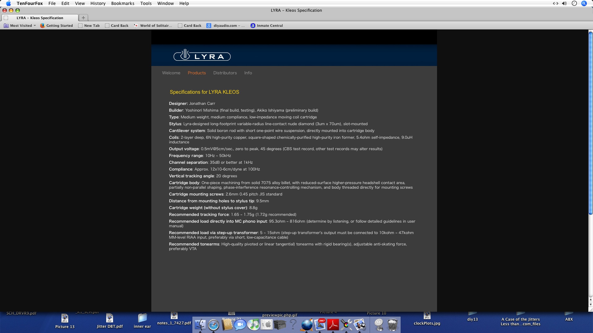

The attachment is a good example of specification. I wish more manufacturers would be as comprehensive.The mismatch of the week:
