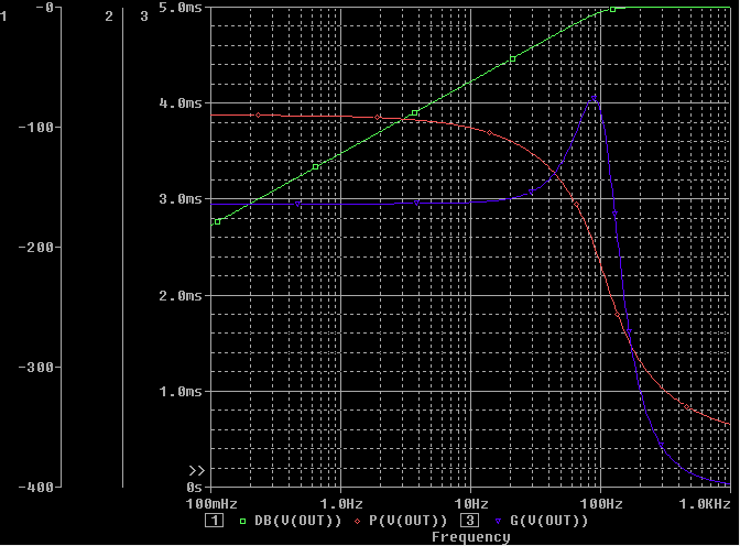

??? No, SK is a conventional min phase filter, with normal group delay........
That's what I said you can't have max 2.5mS GD change with a 20Hz min phase filter.
I have seen this number related to bass and to 100Hz in particular.... must be well established. Here is one well known company which again quote 2.5mS at 100 Hz. We can use that for now, IMO, for lowr freqs as well. I would suspect though that at 20Hz it could be relaxed some. I'll drop it off when it comes by again.

Grrrrr.... 100Hz is NOT 20Hz. A 3rd order Sallen-Key can approach those 2.5mSec group delay at 100Hz (although I don't see why a 3rd order is required, since we are no longer talking about a TT subsonic filter).
