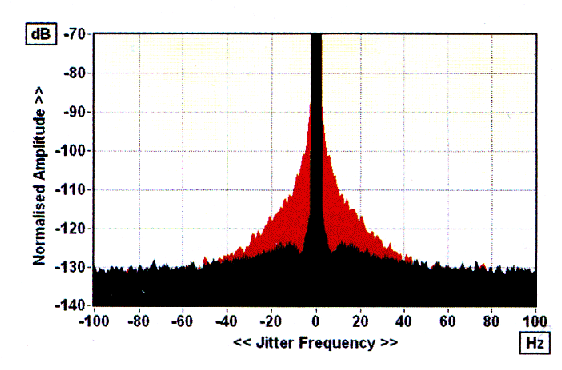

some people here have looked: H I F I D U I N O: Clock in Buffalo II DAC
but they didn't plot one I found a while ago:
if you want to throw money at the non-problem then Vectron EMXO series evacuated SC cut with low vibration sensitivity may make more sense - they claim to be able to "significantly" better the -130 dB@100 Hz close in noise on request - but you'll probably have to pony up for a 100 piece min order
