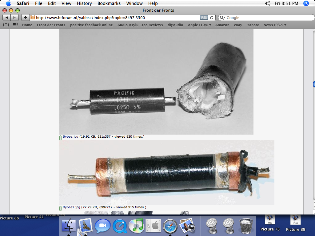

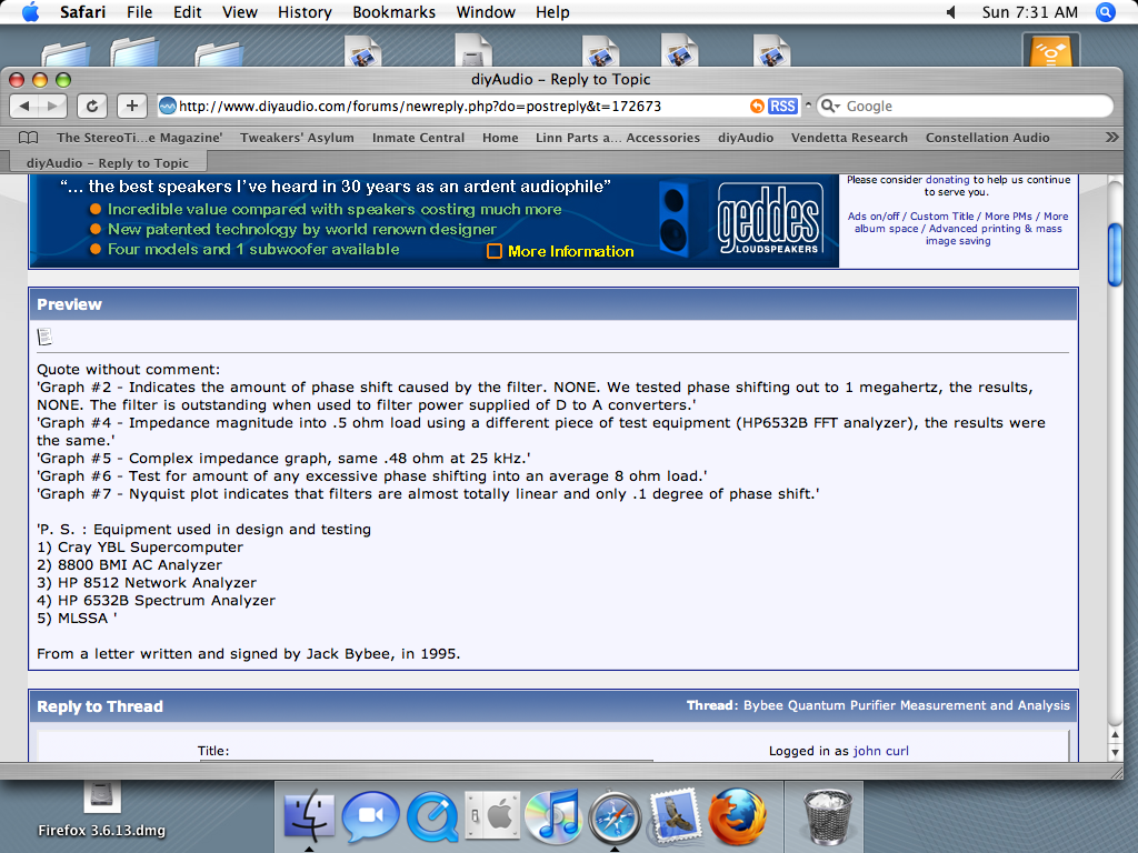

john curl said:
However, the device measures EFFECTIVELY as a 0.025 ohm resistor, with modest inductance (nanoHenries), almost 0 capacitance, so where is the BEEF?
If it measures as a 0.025R resistor, with small inductance and little capacitance then that is how it behaves in a circuit. Measuring it puts it into a circuit! The only exception to this would be if it included a narrow-band filter, and the test used a different frequency so didn't hit the spot.
A two-terminal passive component in a circuit can only interact with that circuit via its terminals or via coupled electric or magnetic fields. In the latter case you would see some capacitance or inductance - as the field has to couple to something in the component. No matter how magic are the nano-bits of which it is made, it must couple in one of these ways. No coupling means no circuit action.
Richard, why don't you get an individual Bybee device just like SY did and measure it? Here is some added input. The active Bybee is an other animal entirely, and you could easily measure its effects, but I don't own one.

But Richard, you showed me my first CRAY computer. '-) decades ago. Remember, the letter was written 20 years ago, and the development done, perhaps 40 or so years ago. The computer time was used for development, not measurement. I have the measurements made in 1995, and they show little, if anything, and THAT is what I am warning you about.

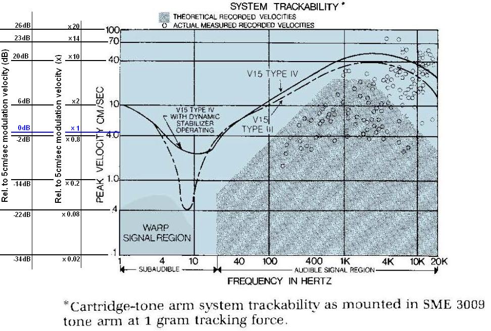

That's correct Brad
At 1kHz the gain of that RIAA pre is 35.5 dB.
So, at the overload limit (180mVrms input), the unit outputs a huge 10.7Vrms signal !
1 Vrms output is reached with a 16,8mVrms from the cartridge.
The Rec-Out reaches 1.28Vrms (the 0dB for many soundcards) with 21.6mV/1kHz rms from the cartridge.
That’s 18.7dB above the 0dB (5cm/s modulation velocity) for a 2.5mV cartridge, 12.7dB for a 5mV cartridge and 6.7dB for a 10mV cartridge.
It seems that for our current needs, for proper gain structure and no downstream overload , MM RIAA stages should have much lower gain than in the past, I would say around 20-22dB/1kHz. (A cartridge with 1mV/cm/s output, when reading a groove with a modulation of 26dB above the 5cm/s, it will supply 100mVrms. If the RIAA preamplifier output is to provide 1Vrms with such an input , it should have a gain of 20dB at 1kHz )

How can something that has no phase shift and flat magnitude response filter anything?? This is nonsense.
