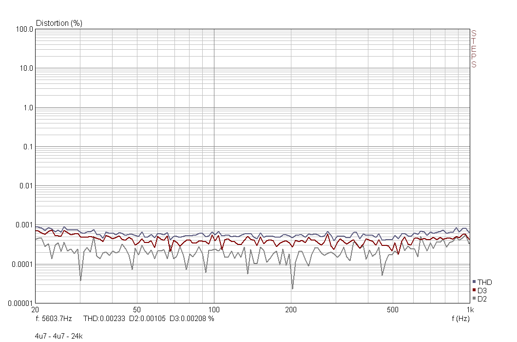

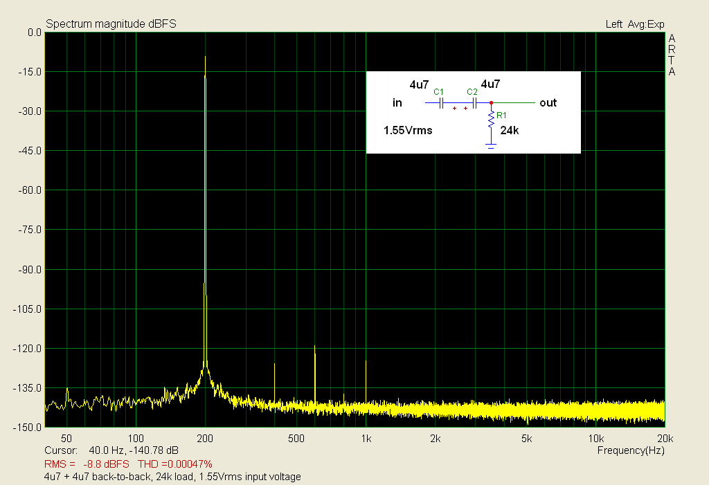

OK. This result, with 2 back-to-back tantalum capacitors is from standard use as a coupling capacitor. Reminder - my method is at the limit. Is 0.00047% too much? Do you want different load, THD vs. frequency plot, test place photo?
I just repeated my 32 year old test with the same tant cap values and the same test conditions. Inverse parallel was about 15dB BETTER than the same parts in series. 20db better compared with a single 4.7uf tantalum cap. Perhaps my test conditions encouraged this result, but I don't see how. What SY measured, I cannot answer for.
When you put them in anti-parallel, the equivalent capacitance is 4 times than when they are placed in series. So the test voltage across the cap is 4 times smaller. I would expect that it indeed drastically lowers distortion.
Four times lower is 12dB less.

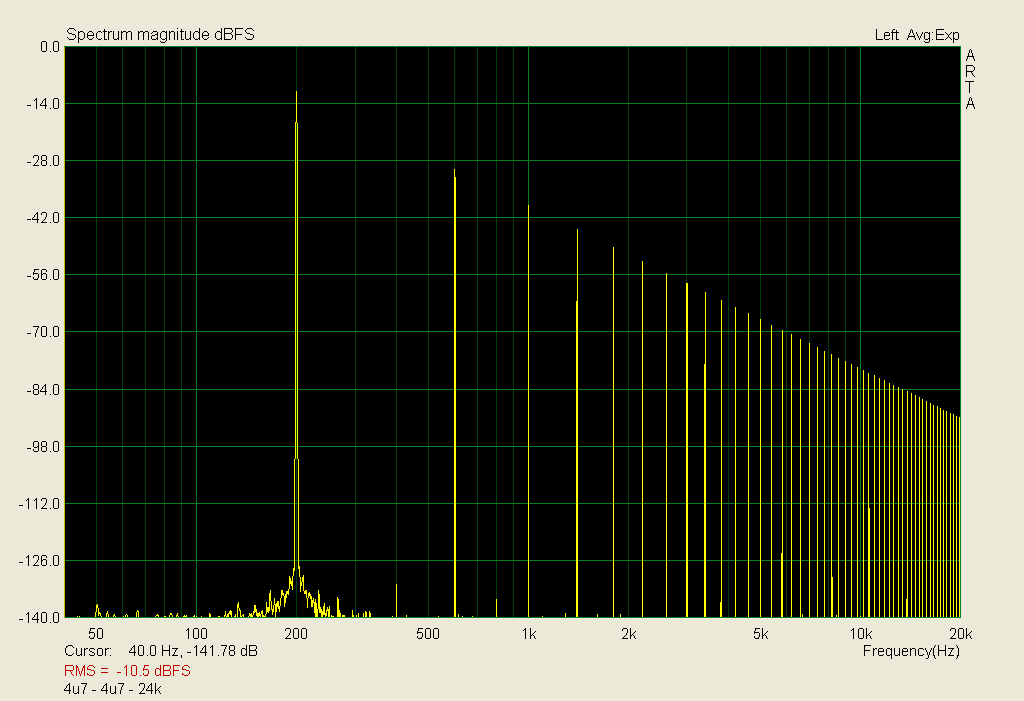

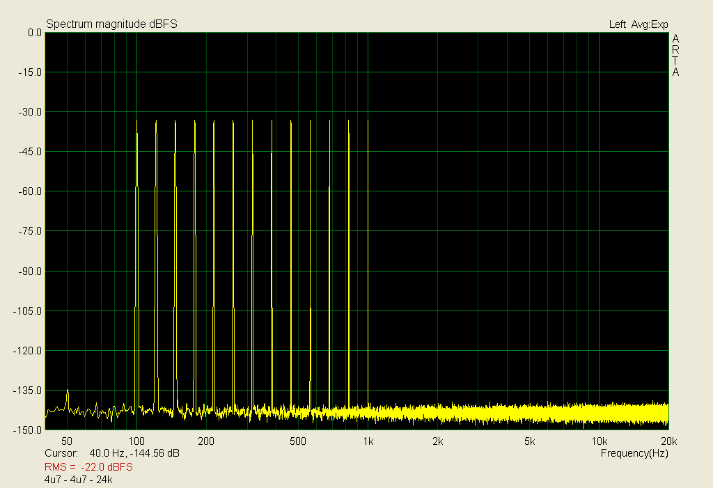

More with tantalum 4u7 - 4u7 back-to-back. Triangle (4.40 Vp-p) and multitone.
P.S.: The part under test is 4.7uF/6.3V
The further test with a single part has shown no worsening in distortion.

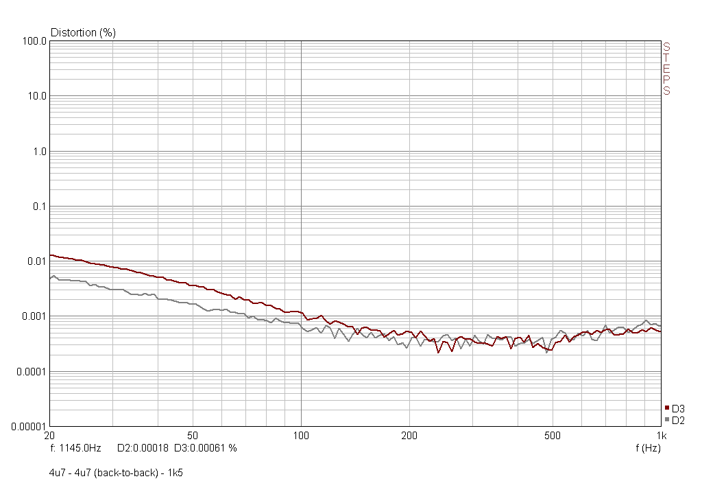

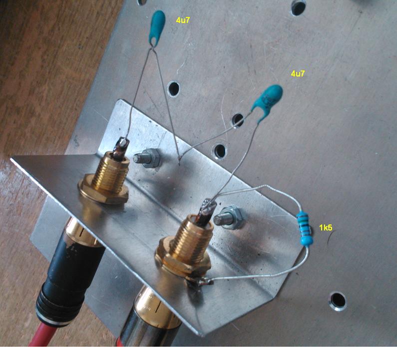

All else same, load changed to 1k5 and only one tantalum capacitor 4u7. High pass filter with 23Hz -3dB frequency corner. Yes, now we can see something. But everyone would make a LF corner somewhere at 1Hz - 2Hz, and then, no distortion even with tantalum. Myth disproved. Parallel x series explained by Jan.
P.S.: comparison with 2 x 4u7 back-to-back added. See H2 reduction.
My test voltage was 3V rms.

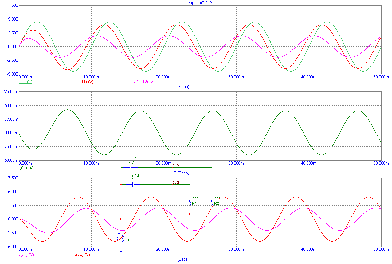

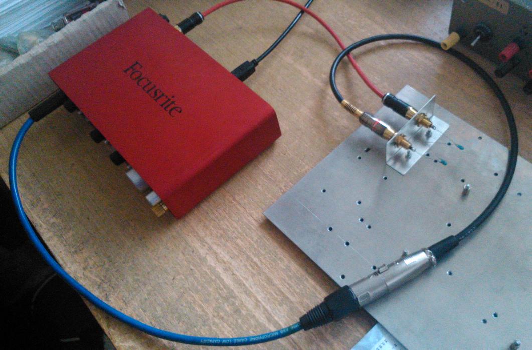

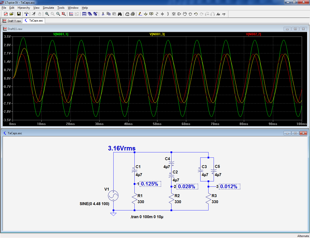

I was curious enough to make the test myself; see pics for exact conditions & voltages across the caps.
To my surprise, in those conditions, the anti-parallel version comes out better.
Tantalums were 4µ7/35V, hermetic metal case
4 x higher capacitance than for series connection. Already explained by Jan. (Change load to 82 ohm for parallel).
ITo my surprise, in those conditions, the anti-parallel version comes out better.
Of course it does, as predictable.
Can you try again by doubling the series caps and halving the // ones.
Jan
Look at the voltages across the individual caps they are practically identical for the series and anti-parallel cases. I have chosen the 330 ohm for precisely that reason.4 x higher capacitance than for series connection. Already explained by Jan. (Change load to 82 ohm for parallel).
Are you sure that your test equipment doesn't have an internal coupling capacitor: your measurements yield much lower absolute THD levels than mine anyway, and apart the fact that you used tantalum drops, there is no significant difference

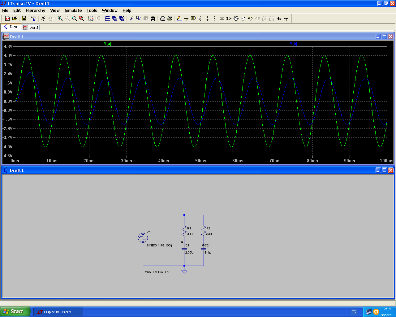

I have resistor load made with a real component. 4 x higher capacitance makes 4 x less voltage across it.
You are showin a node voltage (resistor). Plot capacitor voltage, phase shifts make difference. No simple amplitude addition here.
How can that be - it appears to repeal Ohms' and a couple of other guys laws!
jan
NoYou are showin a node voltage (resistor).
That is exactly what I have done: Look at the pic: the voltages are not absolute, they are of the form V(Nxyz, u)Plot capacitor voltage, phase shifts make difference. No simple amplitude addition here.
You should probably try to explain LTspice that it isn't allowed to make vectorial additions, just arithmetic ones...How can that be - it appears to repeal Ohms' and a couple of other guys laws!

How can LTSpice can measure *real* parts ?I was curious enough to make the test myself;
I'm often surprised how often i read "Measured" in forum, instead of "Simulated".
