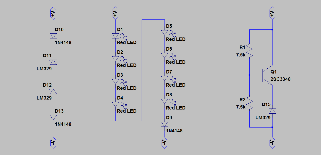

I hope you wouldn't mind if I post a slightly off topic question.
For an application similar to a cap multiplier, I need a low noise 15V "Zener" (2 terminal voltage reference).
Dynamic impedance, absolute voltage, and thermal stability are all not so important, only noise.
Which one of the 3 in the attachment would you choose, and why ?
Or perhaps ever better suggestions (e.g. a simple Zener // a cap) ?
(I know Samuel likes 1N829A, but they are just unobtainium now ........)
Many thanks in advance,
Patrick

Patrick, what current?
Jan

Probably the LED chain.
Nothing with gain since that multiplies the noise voltage also. (The problem of the band gap references)
With the chain, the voltages add normally, the voltage noise only with the square root of the devices.
A string of NiCds probably would be the best, but has long-time problems.
If indeed dynamic impedance and stability were no issue, I would also choose LED chain for the reason named, perhaps even add a cap in parallel.
Otherwise I cannot choose between LM329 chain & the "Vbe+LM329" multiplier.
2x LM329 in series is 1.4x the noise of one.
But I can reduce the noise of the multiplier with a cap across the top resistor ??
And then the multiplier is better, at least theoretically ??
I read somewhere that the LM329 becomes unstable when paralleled with a cap.
So no such treatment for the "329 chain" solution.
Patrick
I think the capacitor would only improve the gained-up part of the total voltage.
Corner frequency would be 0.2 Hz and time to 95% charge 2.25e6 usec
as my RC popup tells me.
A cap across a low-impedance source is not a good filter since it starts to be good
only where its impedance becomes less than the source. Adding a resistor between
the source and the cap helps, but the thermal noise of the resistor is then against you.
The resistor would also help against the instability.
60 Ohms = 1nV /sqrt Hz, increases geometrically with R. There is an optimum
that is function(reference impedance and noise, cap, wanted noise corner).
Someone should write a spreadsheet.

A look at a more complex circuit in which a JFET is used to develop a reference voltage across a parallel R-C and a simple three-Q shunt regulator is used, with some gain but with another C across the feedback resistor, appears to allow a 10mA 15V shunt regulator with about 400nV rms noise in a 20kHz noise bandwidth, with some uncertainty in the very low frequency noise.
But that's a fair amount of parts. Noise is dominated by error amp e sub n, which at the particular choice of operating current and 50 ohm rbb' devices is about 1.7nV/sq rt Hz per device. Lower rbb' parts and a little more collector current could reduce this further.
I was surprised, recently, to measure some 3.9V 500mW zeners and find their noise lower than I remembered, iirc about 11nV/sq rt Hz. That's really quite good for a standard part and not a buried zener. Probably some slightly higher voltage parts would still be reasonably quiet, and with zeners you are free to bypass with capacitors to your heart's content without fear of instability. 5.1V parts are close to zero tempco as well.
Still remember the type & manufacturer ?
Patrick
Out of my parts stock from years back and not easy to identify I'm afraid.
I had recalled much higher noise in a discussion with dvv, but then remembered that I had been adjusting current in nominal 5.1V parts to get a zero tempco, and this may well have been very suboptimal for noise.
So if 5.1V parts are 15nV/sq rt Hz three in series will amount to about 26nV/sq rt Hz, which is pretty decent for a 15V equivalent.
