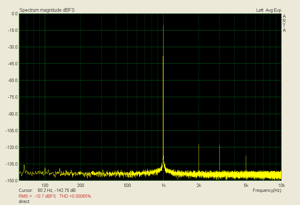

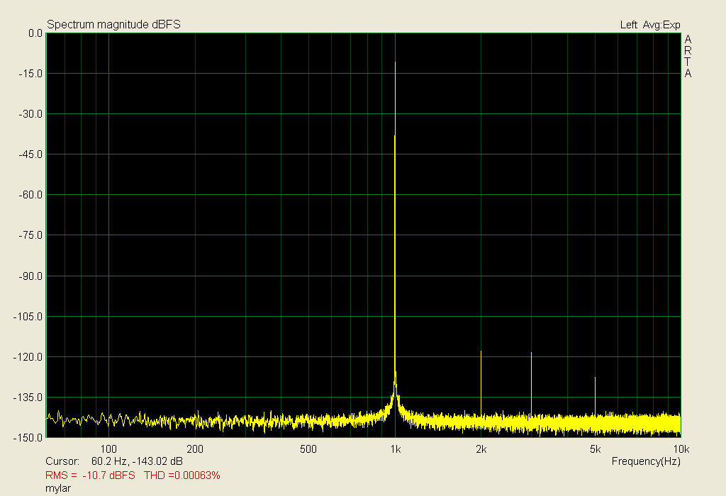

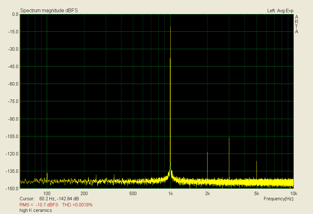

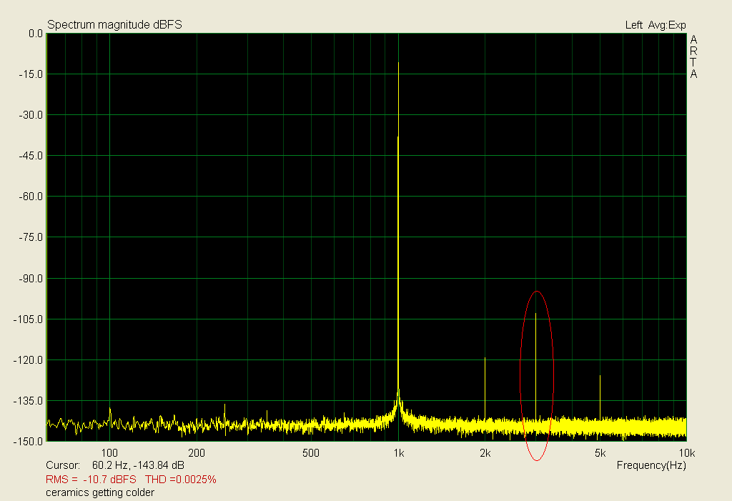

You are oversimplifying and you are NOT right. Please see 3 measurements - direct, mylar cap 3.3u, high K ceramics 100nF, load is 24 kohm, input voltage is 1.55Vrms. Ceramics adds distortion, H3. Worse, the distortion is temperature dependent (highly). If you want for me to check 100nF mylar as well, I will, but I know it adds nothing.
Sorry, I was exaggerating. In the real world coupling caps do carry a small signal current so do have a small voltage change, so dielectric nonlinearity can play a small part.
I may happily use a ceramic coupling cap in a communications receiver, or even an ordinary broadcast AM receiver, but rest assured I would not do this in hi-fi!
Which case size and is the dielectric X7R, X5R or Z5U for the hi-K ceramic? 0.002% for 100nF into 24k presumably translates to 0.0002% for 1uF into the same load? Or are there other factors in play here?
Am I right in thinking that the plots show that even a spectacularly non-linear dielectric only produces small amounts of distortion in a coupling cap? So a reasonably linear dielectric can only produce extremely tiny amounts of distortion, far below that produced by active devices and transducers?
Yes, we agree on this, my point is that we should not use the worst possible part just for the reason that it has probably "negligible effect".
