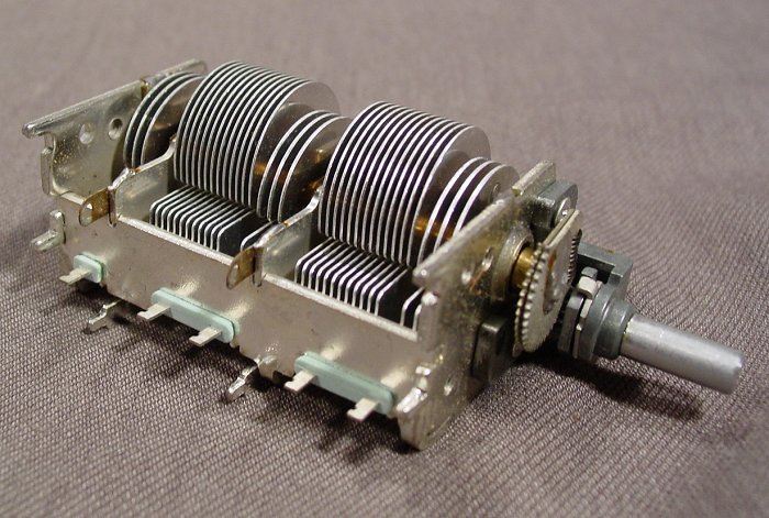

Are you still in joking mode? If there were a charge moving from one plate to the other, the cap would leaking and kaput. Except for electrolytics, where some leakage always occurs.
Air has no dielectric absorption, but thankfully, I had radio in my youth.

We are on the same wave length.Air has no dielectric absorption, but thankfully, I had radio in my youth.
Not for the total behavior of all dielectrics, because it does not show distortions.But I thought it is said to be a good linear model?
What's so special about air? Just one of an infinite series of possible dielectrics. And it's breathable, I give you that. ;-)
