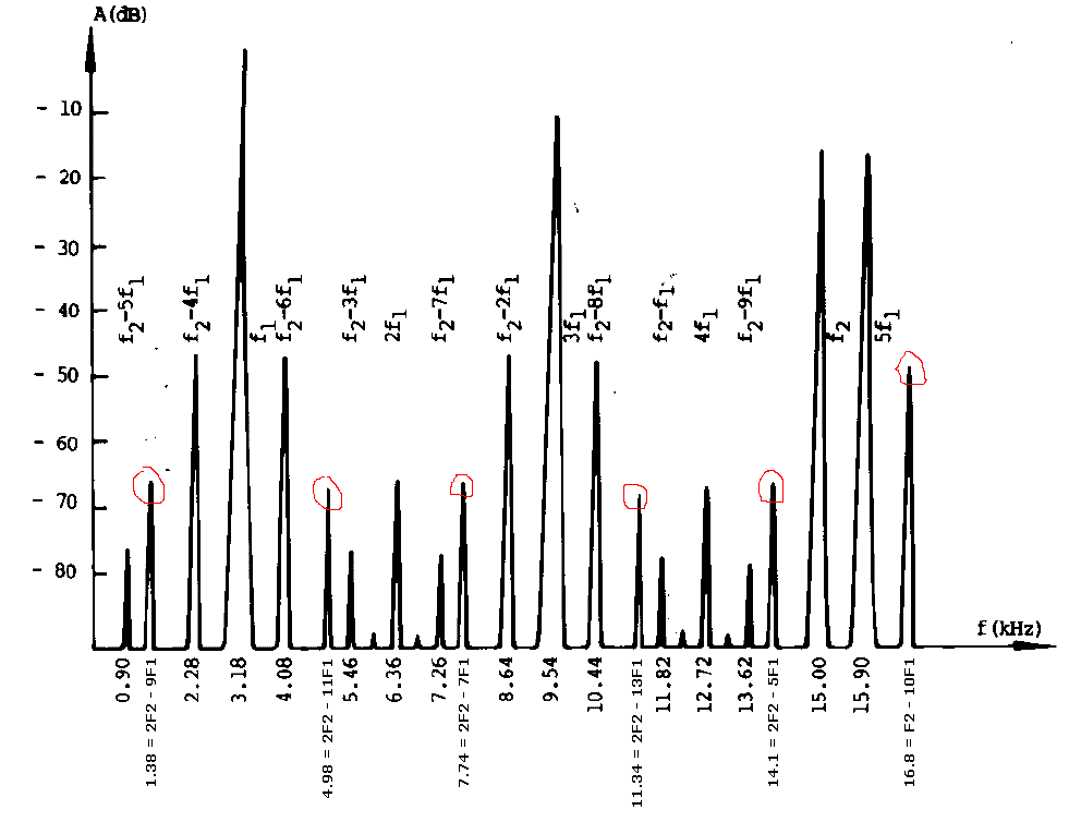

Here's one of the pics from back there, with values filled in for the red-circled frequencies you were asking about. They look like IM products to me.

Godfrey, John claims some tones are 50Hz off, I don't see it. Claiming to read within 1% on that plot is rather optimistic. This plot has become like the Zapruder film or that photo of Sasquatch. I think at times folks use the uncertainty to promote an agenda.

This is the strangest arguement, a magnitude only plot can not separate the two and ALL tones are at the sum and difference frequencies. I saw Ron's paper, an LM358, LM1458, and a 1969 Harmon Kardon receiver. I don't get it, not a single modern device of any kind, it's not as if he doesn't have access to them.
EDIT OK John I just entered the graph into a tool we use when we only have a scan and no data for a graph. 2F2-11F1 is 4.998 vs 4.98 and the 2F2-7F1 is 7.738 vs 7.74. Next....
Apparently Scott, you forgot that on post #6550 that you asserted that it had to be: 2f2-8f1, which is 4.56 KHz by my calculations. Yet it might just be 2f2-11f1 instead, I agree that it COULD be: 2f1-11f1, and it could be that the planet Vulcan is behind the Sun right now. How can I know for sure? Can you? 4.56 KHz would be off by 40 Hz or so, would it not?
John your twisting my words, I assumed that was what we had agreed upon last year. Godfrey's plot clarifies that. I simply meant is has to be AF1+-BF2 and without the phase this test cannot tell PIM from TIM.
