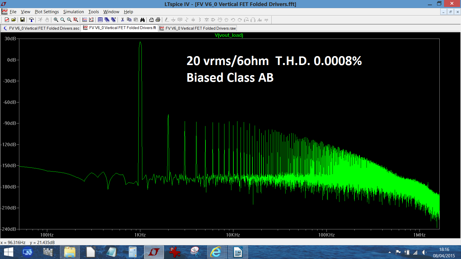

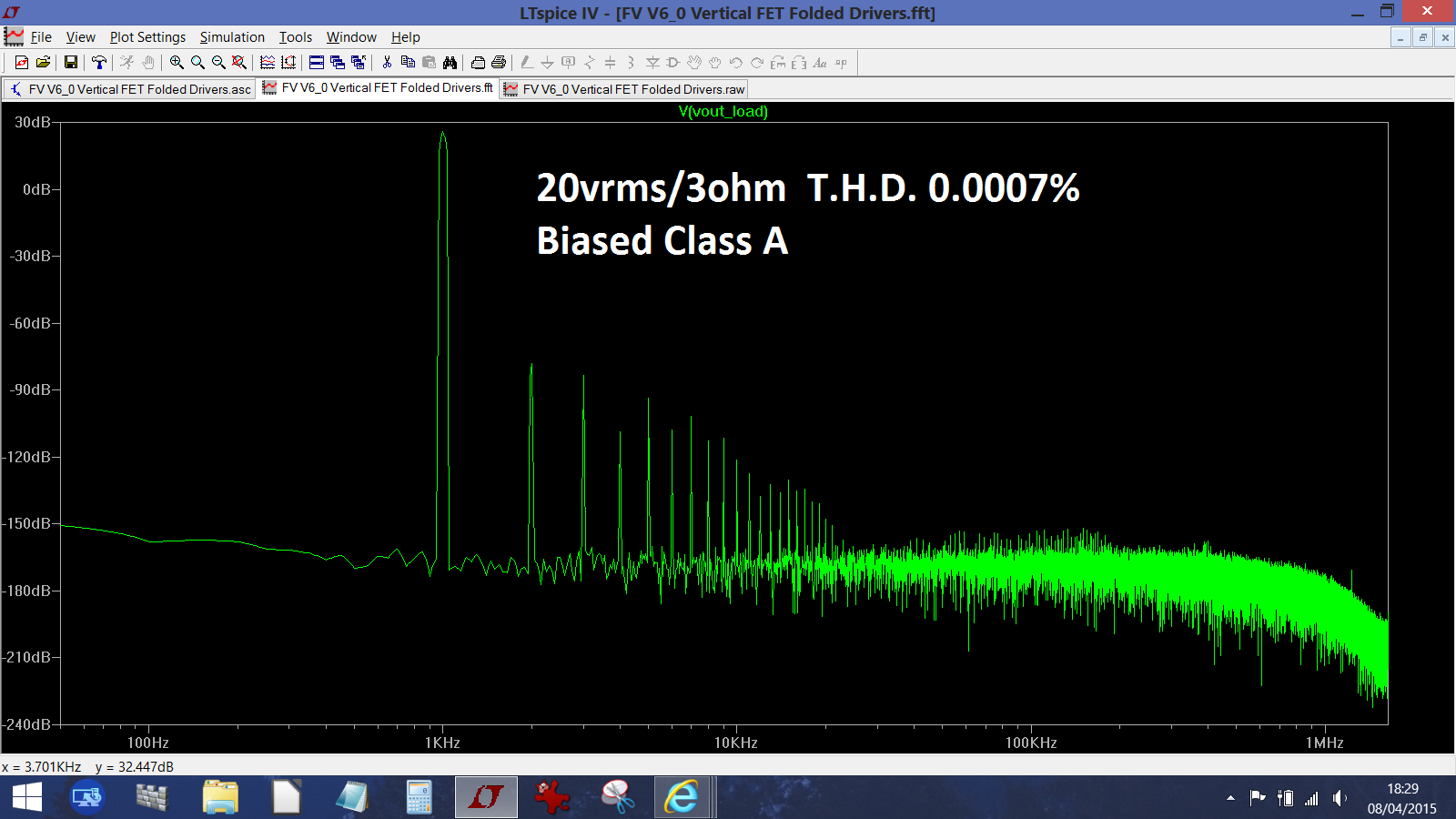

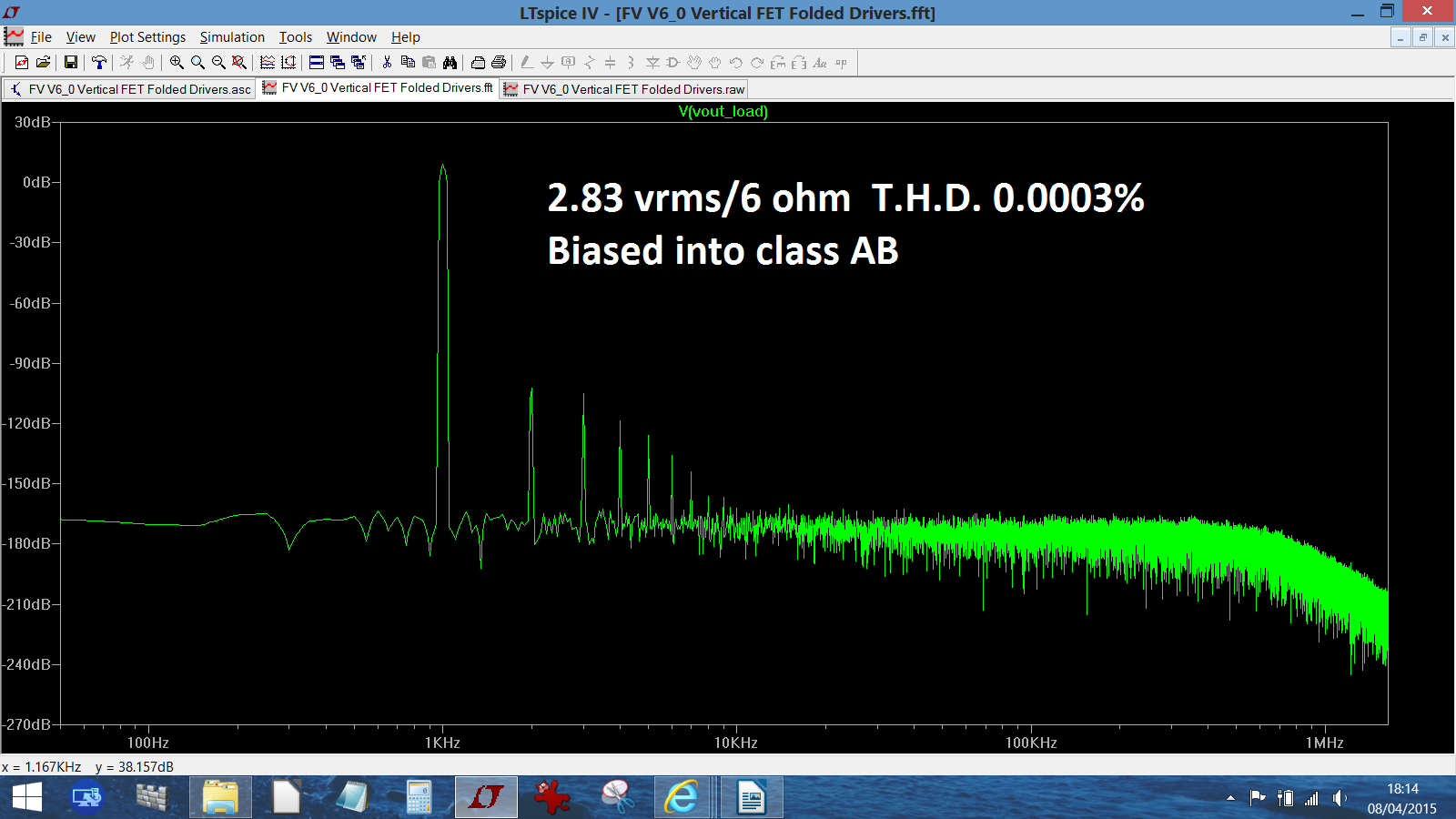

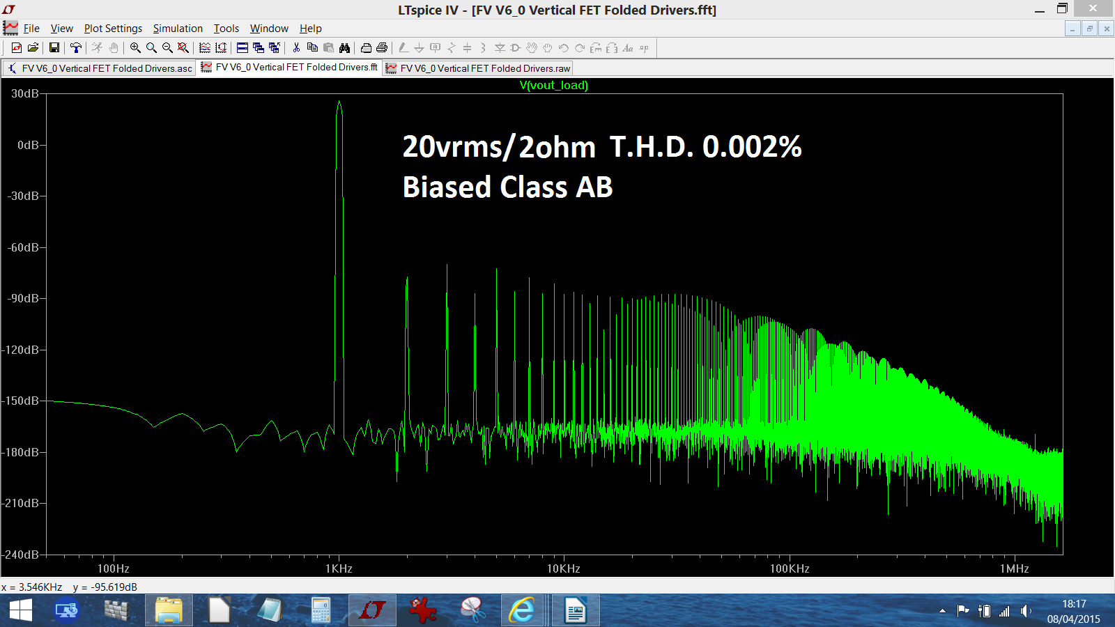

Actually I think looking at distortion spectra of amplifiers and how that changes under adverse conditions can be quite revealing but I suspect there is far more to it than that... far more as in what translates to a great overall sonic result. High open loop gain, immunity to RF appearing at the speaker terminals (ever scoped across an unterminated speaker and its leads ?) and good behaviour in the presence of voltage fed back to the output... those big speakers also make pretty pokey microphones too.
I'm currently working on a new power amp that majors on high current delivery and ability to drive low impedance loads rather than high traditional xx watts/8 ohms. How it will all work out... lol, well I'm not quite sure but the initial results are promising. The design has high open loop gain but runs with a very low feedback factor when judged against typical designs. It is designed for class ab (I'm not a class A fan) but the results when it is biased into class A are pretty decent too.

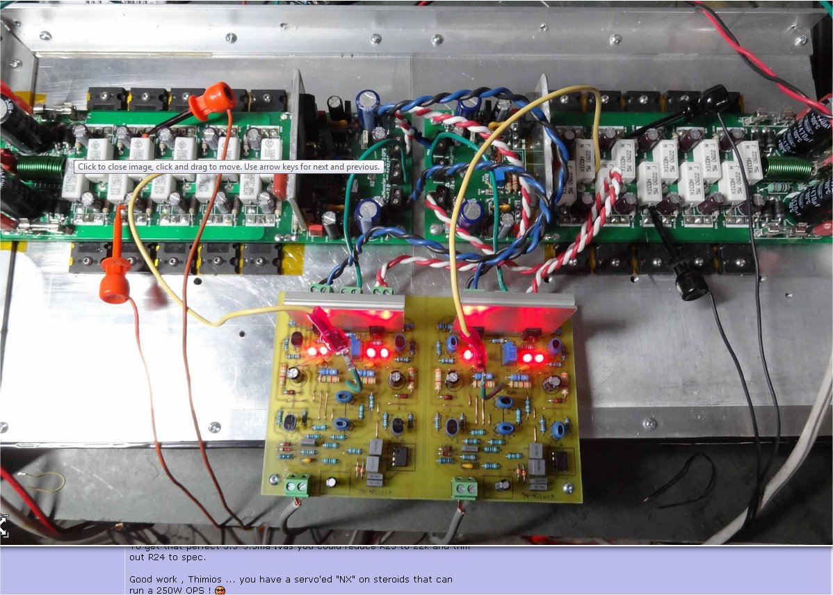

DVV ,
Why do think I'm listening to a 250W H/K 680 right now (that can do 1/2Kw peaks).
I have the original 680 , gave it to my daughter. It beat the pioneer's , sansui's
all the other mid-fi that has passed my bench by. (I kept the H/K - it stood out).
PS - here is a HK !! (below)1/2 KW of 680 OPS's shaking the house
powered by a 400V/uS CFA - Blasphemy !

What MOSFET models are you using , those HF artifacts in class AB are
excessive.
Most BJT class AB simulations will give a cleaner output (below - 40Vrms).
You DO have your noise floor down , but the real life devices will most
probably perform better :D
Cordell or keentoken might have some superior models.
