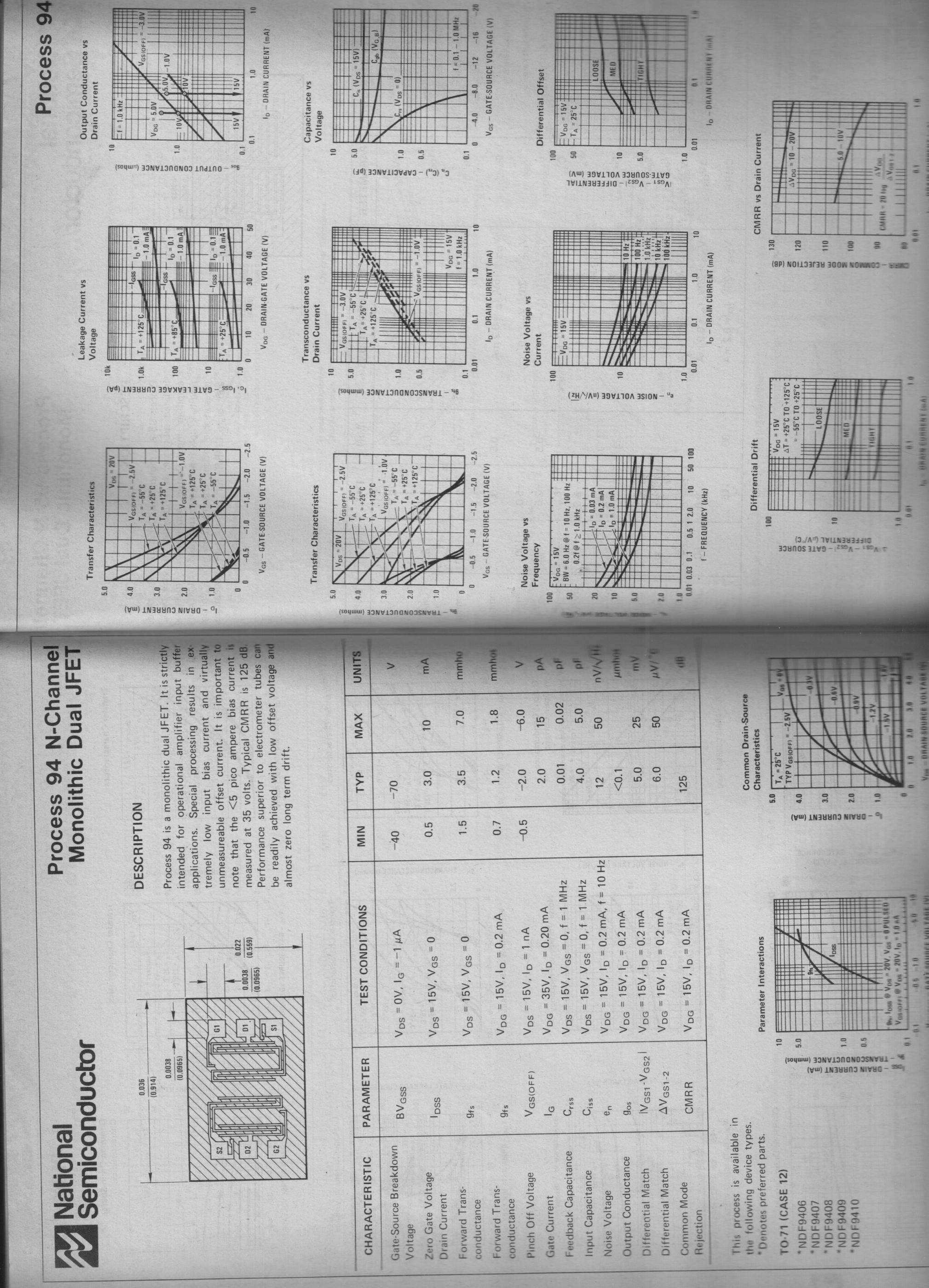

Darn Bcarso, you went all out! At the time, there was also the NPD5564 and the 2SK240 available, years before the 2SK389. They all worked pretty well. The NPD5564 was a monolithic matched fet pair from National, and the 2SK240 was two 2SK170's that were computer matched and factory placed inside an aluminum can.
Some people hold out for full DC operation, and I cannot disagree with them, except for the hassle. Servos are easy, BUT can be problematic if compromised in some serious way. Usually it has to do with using the servo as an audio filter, as well as a DC control, or not decoupling the servo well enough.
The good old NPD5564 was indeed a great part. I think I still have a few in my basement. I can't seem to locate the old spec sheet, though. I've wondered how close the 2SK389 is to it. I think they are pretty close, but it is possible that the LSK389 was a little quieter.
BTW, I seem to remember that there were some devices around that might have been called 2N5564 that were also a two-die solution in one package.

The 389s were appreciably larger area and about a factor two or more lower noise. Higher C of course.The good old NPD5564 was indeed a great part. I think I still have a few in my basement. I can't seem to locate the old spec sheet, though. I've wondered how close the 2SK389 is to it. I think they are pretty close, but it is possible that the LSK389 was a little quieter.
Bob
These?BTW, I seem to remember that there were some devices around that might have been called 2N5564 that were also a two-die solution in one package.
