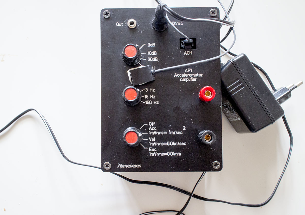

As to cheap vibration sensors, the famous Greek audio George Ntanavaras, produced a kit for an accelerometer that works really nice. PM me if you are interested in his coordinates.
George Ntanavara’s original article:
http://audioxpress.com/article/Test-your-speakers-performance-with-this-do-it-yourself-measurement-system.html
He may still have some pcbs and front panels left:
http://www.diyaudio.com/forums/swap-meet/262944-pcb-anf-front-panel-accelerometer-preamplifier.html
George
Jan Didden put me on the track of this nifty bit of gear and I applaud George's effort to provide more information on it.
It is all very nice to discuss the virtues of different enclosure materials, like was done here recently, but without capability to measure, it's all gobbledygook.
This gizmo changes all that. It can be used pretty much with the same measurement suite you would use for acoustical measurements. Just attach the pick-up element with some blue tack on panel or cone, excite the system with the preferred measurement signal for the job, and unleash the full power of ARTA to get vibration profiles.

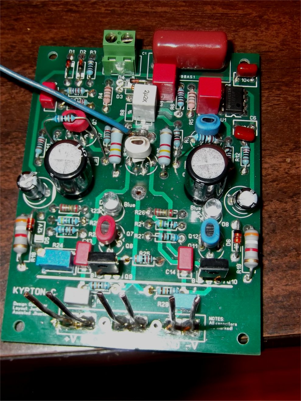

Ostripper..... what page is the CFA amp schematic at ? Pcb available for them by someone, somewhere?
THx-RNMarsh

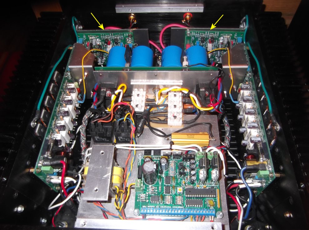

Yes , member Jwilhelm might have some "kypton C" boards (below 1).
They are real easy to get running - the one pictured was "born" over a
glass of fine wine. :D
The schema's are now in my signature (slewmaster/documents/kypton-C).
I'm working on full manuals for all of them , but building from the
schema is easy enough..
Then , you just need the output stage - powers supply (below 2).
Just "plug em' in" .... get to hear any forum design at 200W+.
There are still many extra output stages " in the wild" ask , and
you may receive.
None of these projects have had ANY complaints about performance -
either SQ or thermal. I just tested my bias , only .2mv from where I set it
over a month ago . Real HOT in tennessee today :eek: .
PS - I'm "revisiting" my whole FLAC collection on these different
modules now , some of the detail is astounding.
OS

OS,
I notice you have Valery's protection boards installed there, but the amazing thing is that you have the power supply caps right next to the input boards and you say it is dead quit at the speakers. After watching the contortions going on with the other thread about hum this is truly an amazing design. I just got off the phone with someone and we were talking about a Kickstarter or Indi-go-go campaign for my speaker design with your amplifier to go with it. Now I have to decide if I can really package it inside the speakers or if I should make the amp external and stand alone. I was running the prototypes on a H/K PM655 integrated amp through passive crossovers and you really could barely stay in the room, so I really have to be realistic about how much power I really need, perhaps the two pairs output would be more than enough with active xo's and eq. I am so glad I did not go the monolithic amp route after following this thread.

The caps are about 65mm away from the input stages. The PS caps have very little radiated field compared with the trafo (s).
Comparatively , I can hear my HK680 - it's noisy at -100db.
My sources are way inferior to the amp - need better sources.
Edit - HK PM655 - sort of a POS ! -80db and a paltry 60W (1 pair OP's).
